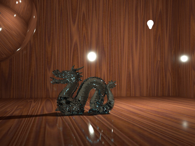

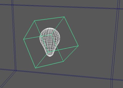

Not necessarily...for example there are "tricks" you can use to emulate small lights. In this scene the only illumination is from the "bulb," which I surrounded with a box with opacity = 0.indexofrefraction wrote:you cant eliminate a small light source if you need a candle.
you cant turn of glossy surfaces if they need to be glossy
so the conclusion is: you cant avoid the flies?
If I set the bulb to be the emitter, it looks like this: If I set the bulb to be white diffuse, no emission, and change the box to be the emitter, it looks like this: There are differences, but depending on what you need to accomplish, you can perhaps increase the polygons in the box to more closely resemble the bulb. But in general, emitters with flat surfaces are less noisy, so fewer polygons = better.
PMC with the bulb as emitter also results in fewer fireflies, but it takes longer to reach 2000 samples.
Here's a wireframe of the emitter setup so you can see what's going on. I rotated the box in order to prevent the emitter surfaces from being parallel to the walls:
