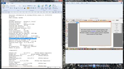

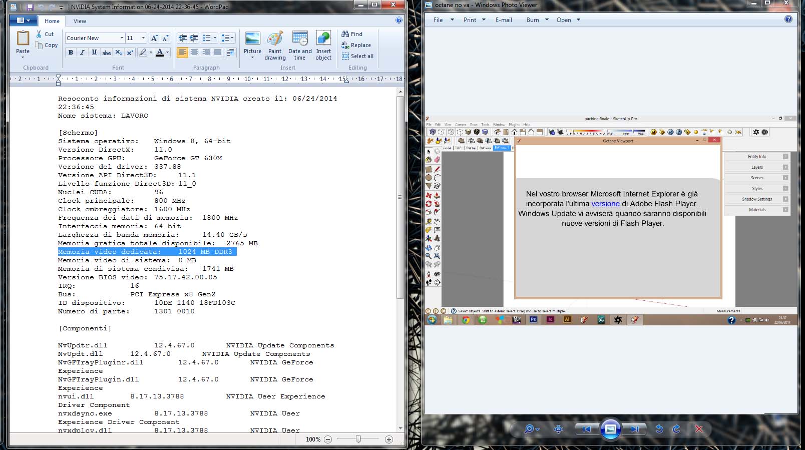

fuzzybro wrote:I have updated the demo links.fuzzybro wrote:Yup. Waiting for FooZe to make them publicly available. I'll let you know.perro_abombao wrote:hi Fuzzibro..I´m trying to share with a friend the demo version attached to your post here...cause in download section is not the latest....but she have the message is not the licensed customer ...please share this in download section...regards!!!
....thanks man!!!! in my pc it´s oK...but...my friend still having this problem...(she have the latest version of flash player)

Hi Perro,perro_abombao wrote: ....thanks man!!!! in my pc it´s oK...but...my friend still having this problem...(she have the latest version of flash player)
Could you please send log files from that machine?
They are located in "C:\Users\%USERNAME%\Documents\Octane\SketchUp\logs"
