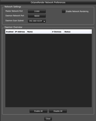

This isn't working for us, and we just bought 5 licenses so we need an answer ASAP if possible. We can't seem to find a way to changes the subnet to scan a range higher than x.24. All the computers on our network are higher than that. We've looked through the DR tutorial and it says you can change it, but nothing as to how...
Posts: 16068
Location: Türkiye
Rodross,
Have you tryed to use "_install_daemon.bat"? It should do some automatic detection for clients.
rodross
Posts: 135
Joined: Fri Jun 27, 2014 3:01 pm
aoktar wrote:Rodross,
I would need to run that on the master?? It's been ran on the client. NEITHER computer can see any subnet over x.24.
Posts: 10512
hi,
firstly use the latest standalone version for setting up the octane network render.
on the slaves, run the install_demon_bat script and press enter to all the questions and finally pres y.
Restart all the slaves and verify in the console window the settings. Allow the private network in the firewall windows. If all is going well, when you activate the network in the master preferences, all the slaves will be visible and enabled. Then close the standalone and work with cinema activating the network render option.
My machines have all ip numbers greater then 100 and are all visible in both mac and win systems ;)
Remember, you can have only 12 GPU (internal + network) per master for now.
