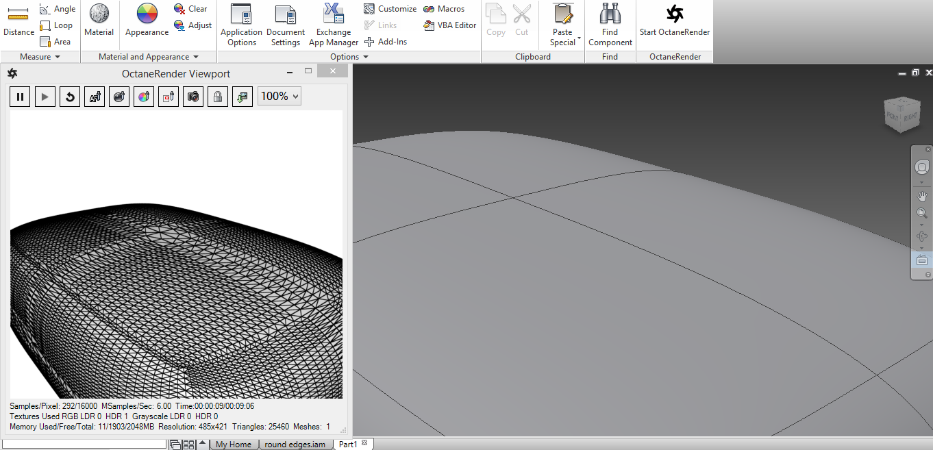

Inventor 2015 t-splines are automatically support by the Octane plugin. Pls see screenshot below (rendering the Infochannel Kernel wireframe to show the triangles created).

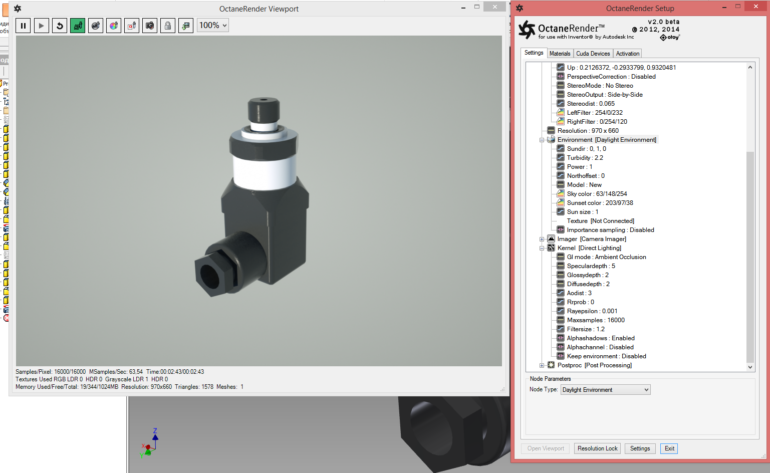

I've tried to render some models and they don't drop shadows to the ground like in original Inventor's raytrace.
What i'm doing wrong? In your video and sample picture shadows are present.
Win 8.1/64 bit/8Gb RAM/GTX 560 Ti/337.88 Driver/Inventor 2015/Plugin v.2.0.3
What lighting are you using? (IBL, Daylight or Emitters?). Also, if your Inventor geometry is very small (ie. millimeters or centimeters) you will most probably need to lower the rayepsilon. If the scene is large, increase ray epsilon. See http://render.otoy.com/manuals/Poser/?page_id=210 for details. If neither of the above helps, could you pls post some sample renders showing the problem. Oh, and I assume you have some ground geometry to cast the shadows on to?

I didn't made any special ground geometry for rendering and I supposed that this is main problem.
What geometry you have used in sample video with "fork-brace.ipt" for this purposes?
P.S. IBL and Daylight gave the same resoult. Changing the value of rayepsilon only gave more sharpen shadows.
Normally you would enable the Inventor Ground Plane. However I tried this on the latest release, and it looks like because the ground plane is such a large polygon there is a problem with the shadows. I will try to fix this when doing the 2.11.1 build later this week. In the meantime, add some additional geometry for your own ground plane.
