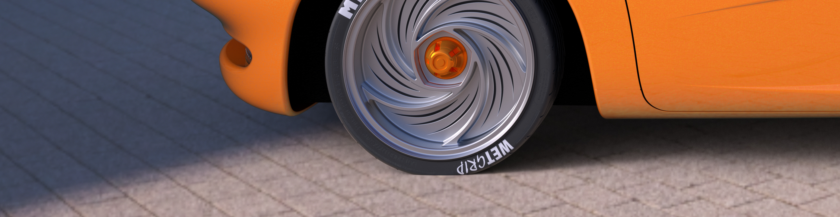

As for color in shadows, here is a perfect example. Notice that the shadow color on the left in the background image (environment) has cool colors in it. Again, this is light source and base color compliments mixed in with the base color itself. That is nature at work captured by the camera. Then look over to the right where you have the shadow catch shadow...It is just black.
Although the shadow catcher color is wrong, there is no easy way around this in a renderer. After all, if you plan on taking the subject with its shadows and placing them over another image entirely, not related to the environment image (in other words, not a backplane image that came with the environment image) then that coloring will look wrong to one degree or another.
The black shadow here, under the car certainly looks wrong, but it is probably easier in PShop to get chroma into that shadow by using Channel Mixer or Selective Color than trying the same thing when the shadow started out with color. The reason is that shifting color in a colored area means parts of that area may start to shift completely into wrong colors when trying to adjust overall. That is a common color correction issue. In the case of shadows, probably best to add color to a black shadow than an already colored one.
Unfortunately, if you go to the extreme of creating authentic colored shadows in PShop from shadows created with Shadow Catcher, then you will need to run a separate render of a mask of your subject, so that you can color correct only the shadows without affecting the subject. The faster alternative is to create your mask by hand in PShop and feather it properly. Some people are better at that than others.
Then again, for the BEST results in PShop, the Shadow Catcher shadow layer should be set to Multiply mode so that details in the background are not weakened. You can't have the subject set to Multiply, so that means either splitting your shadows from your subject into two separate layers via the mask (which means you will get a halo around the subject, unless you tinker with the PShop selection with Expand/Contract), or running a THIRD render of just the subject w/o shadow catcher on, for the beauty pass. If the latter, you will still need the mask then to erase out "swelling" of the subject due to Multiply mode expanding the apparent contour of the subject in the shadow catch layer by a few annoying pixels, beyond what you see on the beauty pass layer above it.

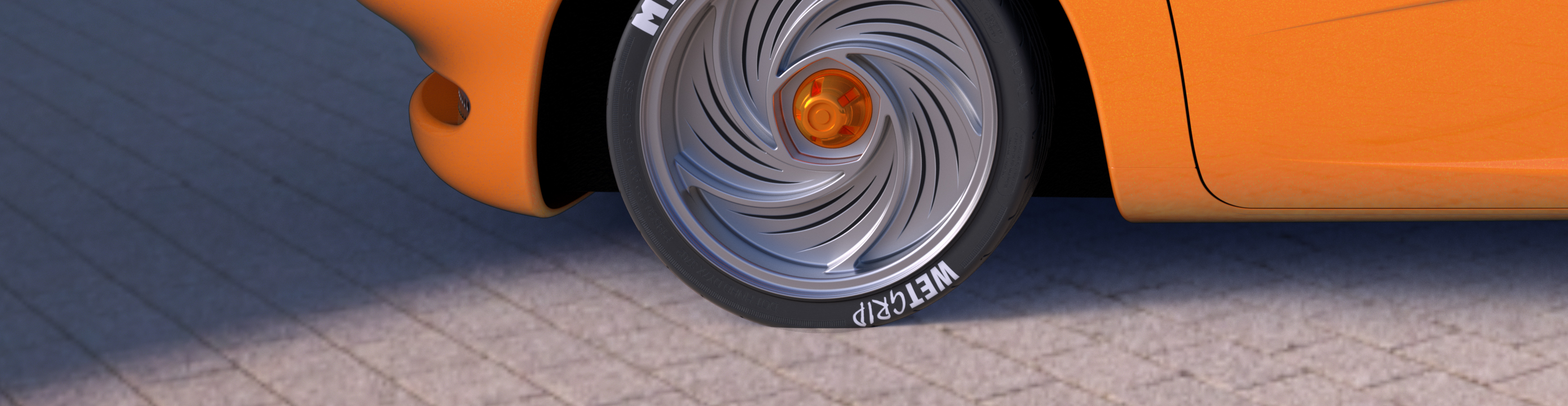

No matter what, for anal quality there will be a fair amount of work to do in PShop. Here is a PShop color-corrected version:
