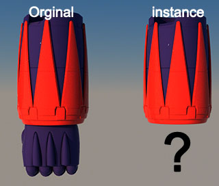

I resolved the previous problem deleting all and reimporting everything and recreating from scratch the sahders.
But now this event: i instanced a object, but part of it is not rendered...
the blue part is missing in the instance.
How i can manage this? Thank you!
instance mistake
instance mistake

yashugan wrote:I resolved the previous problem deleting all and reimporting everything and recreating from scratch the sahders.
Haven´t much played with old scenes, so crashes are possible. Sorry for this.
Can you show me the complete scene tree of the instance scene, or send me the scene?
It can also be a dummy mesh. Maybe i have missed some possibilities.

Here is the scen with instance problem.
thank you! ;)
test_instance.rar
scene with instance mistake
(701.64 KiB) Downloaded 603 times

yashugan wrote:Here is the scen with instance problem.
thank you! ;)
Thanks for the scene.
The instance problem is solved. I has checked only meshes which are child of Nulls or Models. Now i check every parent Object.
The problem with reexport existing meshes is also solved. This was a problem with the SubD level which was only at the first export added to my evaluation checksum. So a second export hasn´t this addition and reported a different checksum, the mesh was exported again.
Have also noticed that the plugin is realy unstable at the first render/preview when the window lost the focus.
After a close and rerender, all is fine. Don´t know what happens, maybe the render context is gone. This would make sense, because the infos in the preview window are also gone.
Hope i can found this problem...
