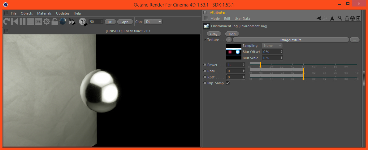

I'm getting a problem that's randomly started, it was in the previous version too, all of a sudden all HDRIs are desaturated:
Any ideas what causes it? I've tried using different HDRIs from different packs but same issue occurs, this is now in all files I setup, normal colour is fine everywhere else, it's just HDRIs.

can you put here? Did you checked a material with some texture in same scene?

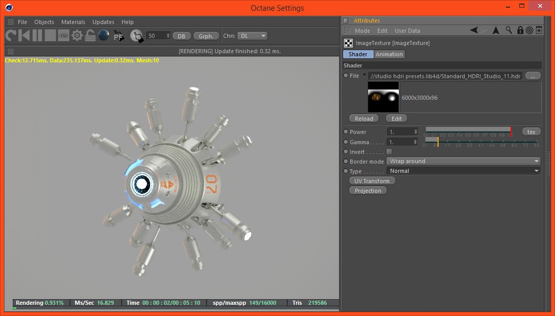

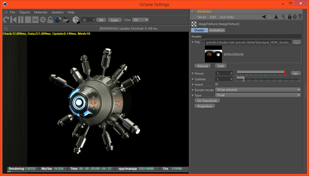

I can load an HDRI in to the Image Texture with it's Type set to "Normal", but "Float" loses all colour. Normal, keeps the colour, but that doesn't work with the Environment tag, and I assume the wrong setting for HDRIs, I've always set it to Float (I think!) :D
I'll send you the scene via PM

Ok, your scene have 5 of 64bit textures. But gpu has a limit as 4. Problem is that. I'll put some control and messagebox for this situation.

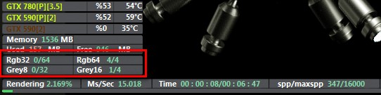

@brasco: Pls check image. This is not a bug. On my gtx590 has 4 slot for rgb 16 bit images, you have 5. One goes to float 16bit.
remove one image, change your hdr to normal mode in sky. Restart render.
