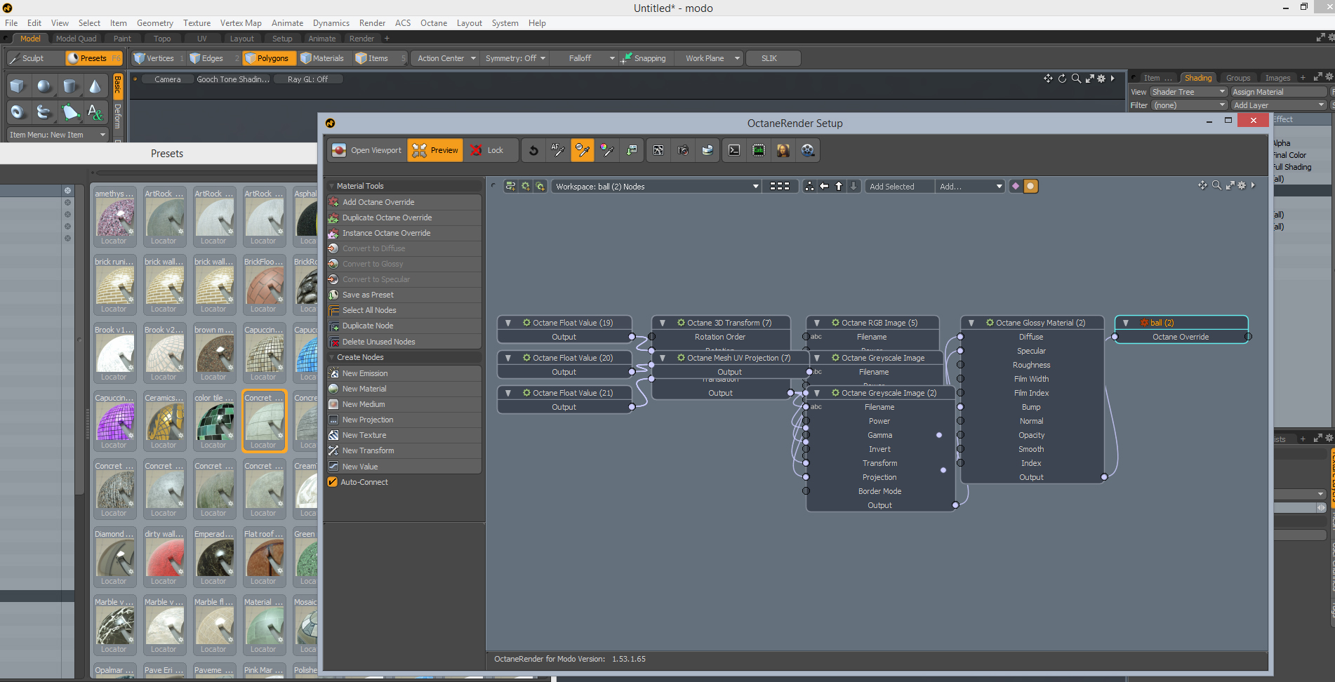

I checked,and redownloaded the live DB Contenet, and yes it does overlap items.
Can you post a screenshot of a material in the schematic pls, so I can compare against my version here? Let me know which LiveDb material you post.

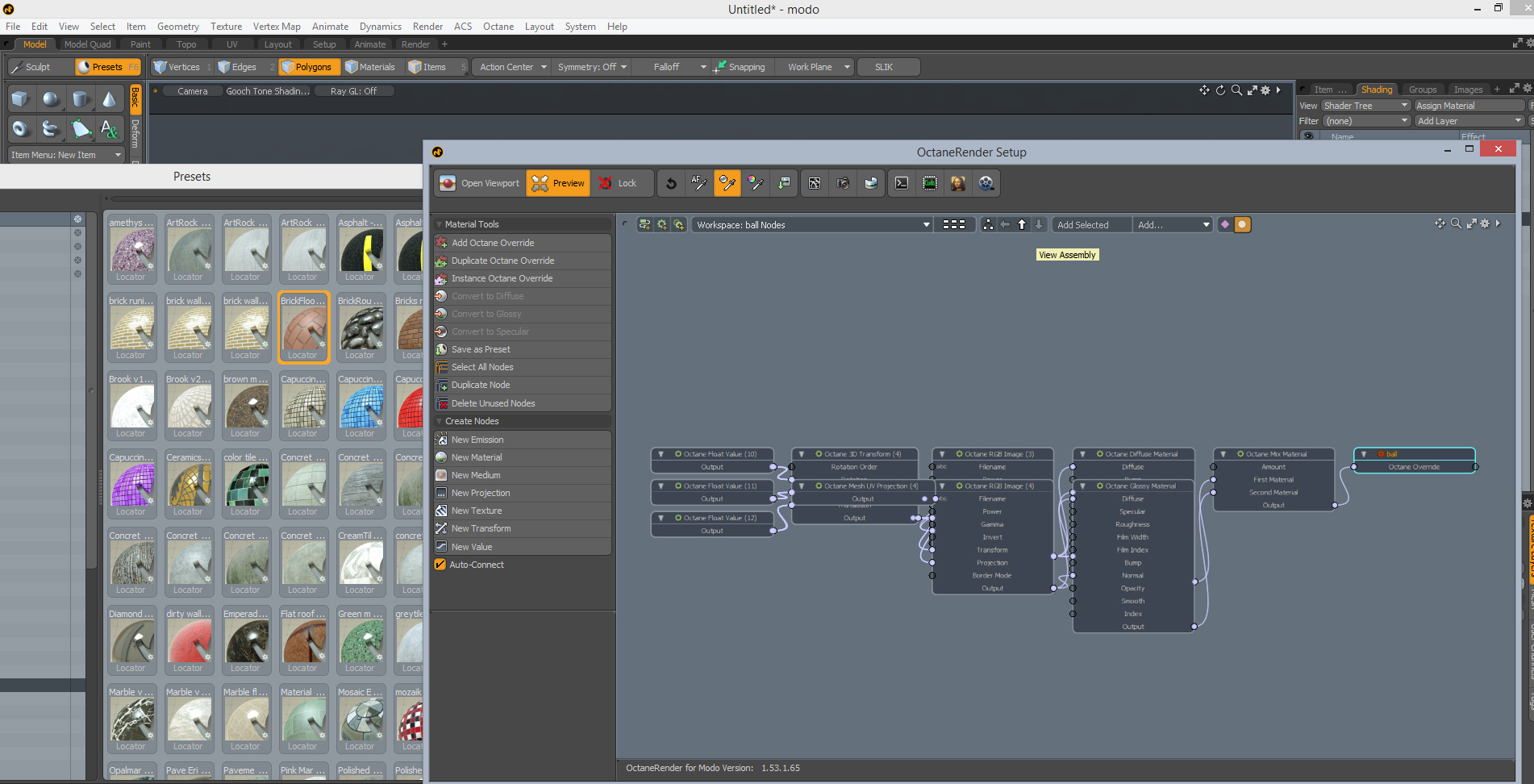

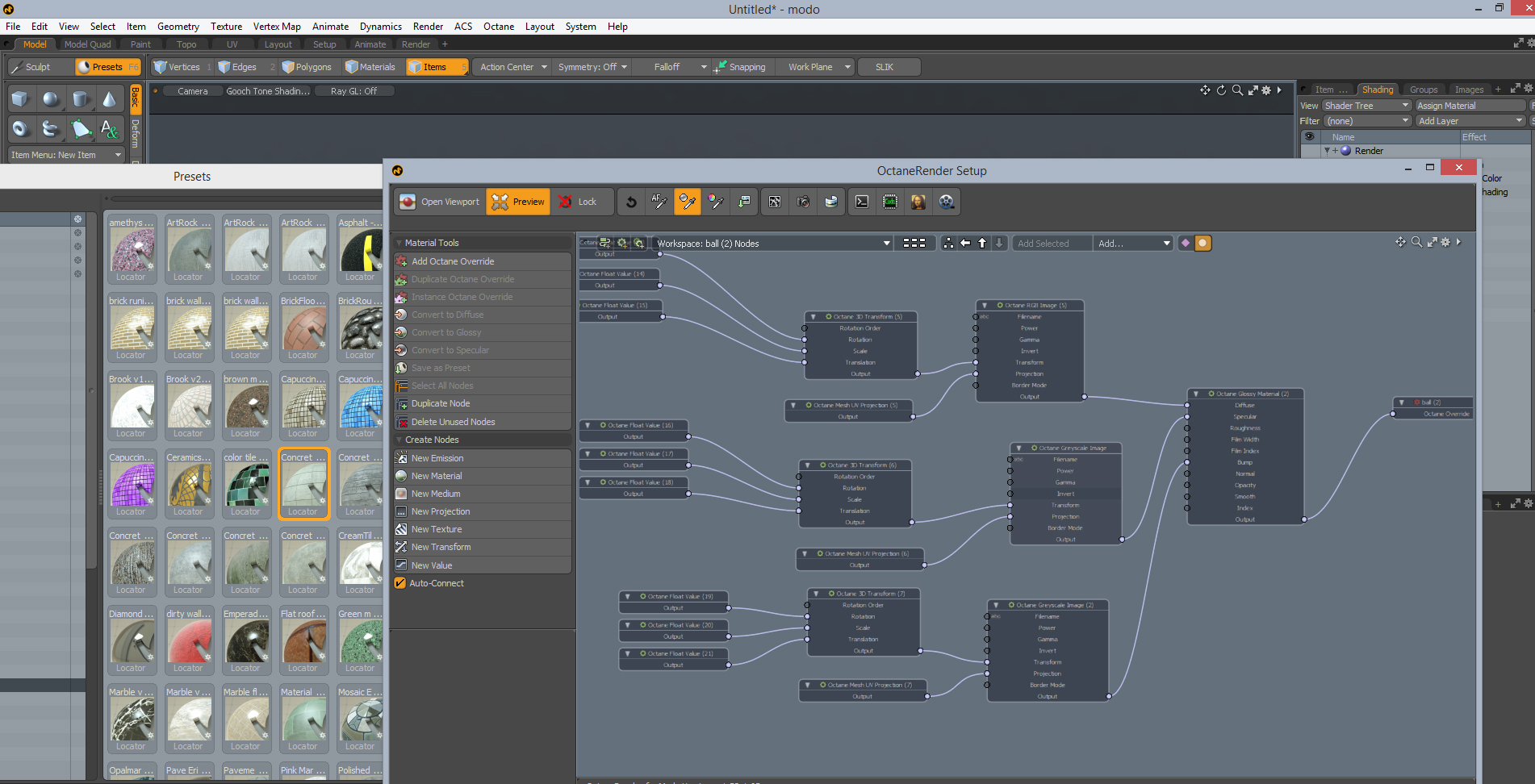

Hi Paul,
The first 2 images, contain 2 random materials I choosed, the third image is my wish of the layout :)
desired layout
desired layout
Preset 2 sample
Preset 2 sample
Prest 1 sample
Prest 1 sample
I see the issue. The LiveDb materials are automatically formatted by the plugin - and the formatting you are seeing it the default automatic formatting. I have tried to use a few of the node layout "clean-up" functions in Modo, but they do not seem to work. So for the time being - that is the format you will get. Over time I will improve this layout, however unless the Modo Schematic functionality is enhanced, it's not possible to determine that one node is overlayed on another.

Hi Paul,
I understand that there is some modo api limitation, but if we found a way to set a miminum distance between the nodes, and a rule to control the position by checking the parent position and set a vertical rule alignment... By the way I am far away from a developer, but this is my designer approach.
I also saw you somehow fixed the horizontal positioning.
Thank you fot the reply
Yes, with a lot of effort this could be improved, but ultimately it's a function that Modo needs to provide - anything I do in the plugin is a workaround, and whilst I will probably look at it in the future, it's hard to justify the time on this when cool new features like Viewport Navigation are awaiting...
