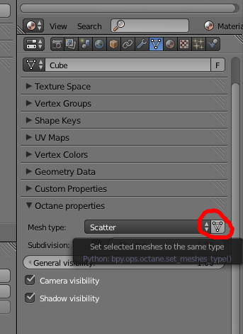

Hey Jimstar, is there a way to make all of the objects you have selected a certain mesh type, or do you have to go one by one? I currently have 100s of objects in my scene and I would want all of them but a couple to be static objects. Then I have several instances as well.
What would be the best way to do this?

kavorka wrote:Hey Jimstar, is there a way to make all of the objects you have selected a certain mesh type, or do you have to go one by one? I currently have 100s of objects in my scene and I would want all of them but a couple to be static objects. Then I have several instances as well.
JimStar wrote:The proper way is set this type inside of each geometry's properties. And you can set the same type to all selected objects using the button there...

Ah, sorry I missed you already answered my question :)
