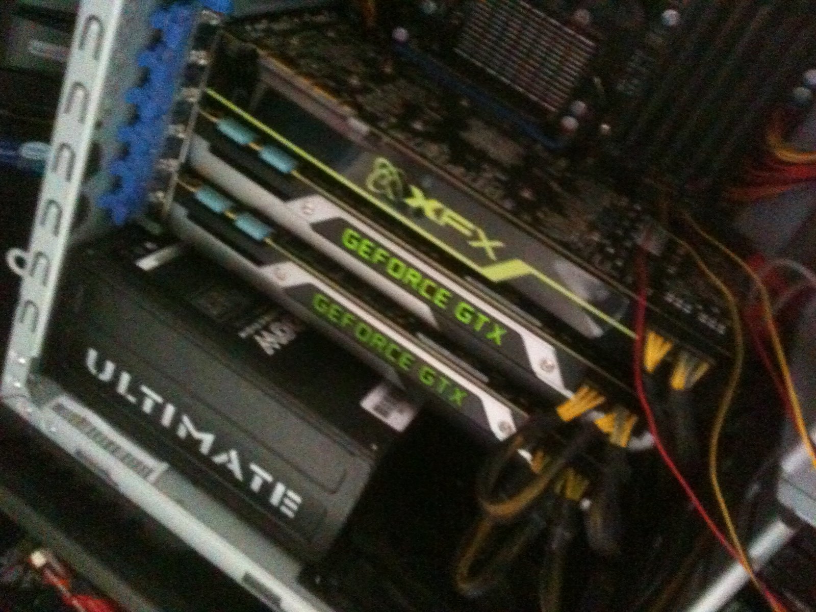

Hi Guys,
I now have added two Titans and a few fans to the machine and it all works great
The case was big enough to add them... The cards are also very close together, and the bottom one is very close to the 950watt PSU, but it works fine.
So far testing I have no problems. The temps of tyhe GPU are about 80/85 degrees while rendering fullmax.
And the noise is pretty low compared to my other machine with 4 580's, but then, the fans in the 580case are with more in numbers and with faster speed.
So, Thanx guys, for all the advice...
