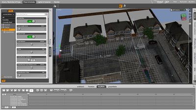

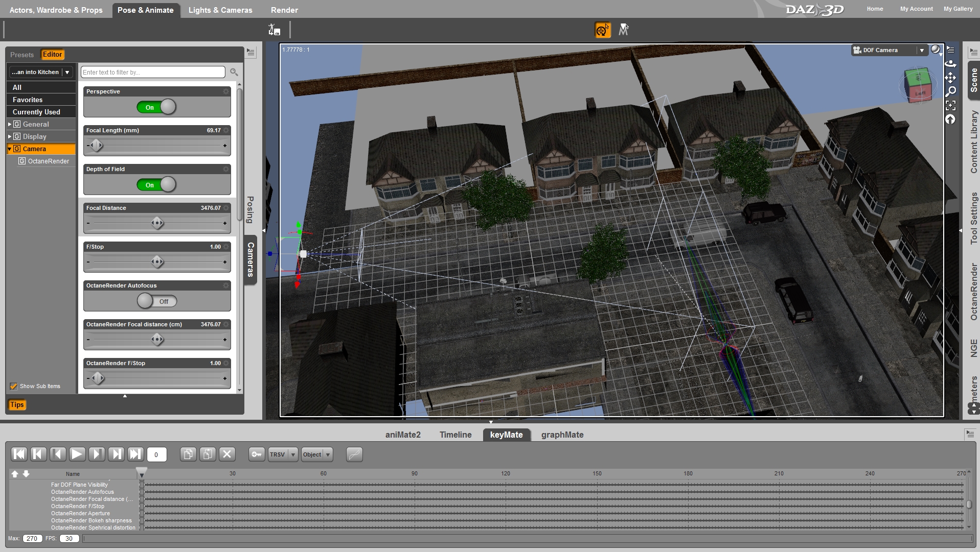

I'm back on Octane again after a long break (Brand new Gigabyte GTX 780 Ti was faulty from new. After a struggle to get the vendor to play ball I get a reconditioned one via the Gigabyte RMA process. Not impressed at all - will not be using either the vendor or Gigabyte again).
The method I am using to get a quick and easy DOF is to use another camera side on to the camera I want to use in the shot. I select the shot camera but look through the DOF camera (the side on one). I now see a wonderfully easy to use DOF setup, where (approximately) the tranmlines are what is in focus.
However, these settings dont affect the Octane render. Instead I copy and paste FOCAL DISTANCE and F/STOP into OCTANE FOCAL DISTANCE and OCTANE F/STOP. I now get DOF. [EDIT - The F/STOP parameters work on a different scale, so no point in copying them.]
It's a bit fiddly. Isn't the "get from DAZ camera" option in the OCTANE viewport supposed to take the DAZ focal distance and f/stop parameters? If it did this would speed up the process.
Any help most appreciated. It's good to be back.
