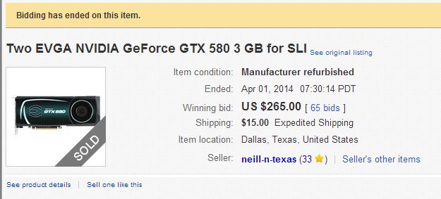

FrankPooleFloating wrote:A 580 3GB will absolutely destroy a 640 4GB and make it crawl away in shame. I got two of mine for $200 each and the others for $150 each...
No doubt it would in terms of power but I don't see very many 580 3GBs on ebay for less than $300 each and most are around $400 whereas I can get 3 640s for $400 all day long.
Also there's the question of whether you actually have 3GB. Isn't it 1.5GB x 2 in a 580?
