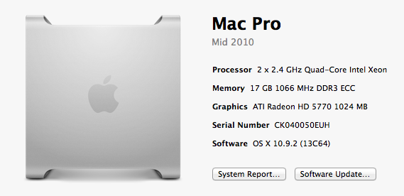

Hello and thank you in advance for your effort!!!
Im uploading the specs!
Im using a MacPro 8core(mid-2010) with Mavericks

Posts: 10616
hi tony,
your mac pro is capable of working with 2x double size nvidia cards for octane plus an extra single size card for display only, but you need an extra psu for make it work.
you can stay with the ati for display and add a gtx only for octane but you could have some trouble with both ati and nvidia drivers working together.
here you can find an old discussion about mac pro and some solutions for the external psu:
http://render.otoy.com/forum/viewtopic. ... 7&start=30
ciao beppe
