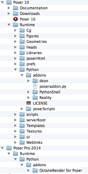

I thought I would add that when I ran the install package, only gave me the option to change which hard drive to install to. No option to select which folder or to find which version of Poser I had.
Here is a screen shot of both Poser 10 and the Poser Pro 2014 folder...

OK - yes, the installer assumes Poser Pro 2014. Would it be better if I simply supplied a ZIP file, and you can copy the contents into the correct folder?However, when doing so, I noticed that I now have a Poser Pro 2014 folder and that it only has a Runtime>Python>addons>OctaneRender for Poser folder. I do not own Poser Pro 2014 so the Runtime>Python....Octane folder path is the only one in there.
Can you post a screenshot of the Poser 10 folder structure after you copied the files across. And when you try to run Poser with the copied folder, is an octaneplugin.log file created? If so, can you pls post it here.

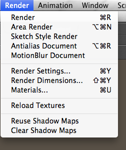

I uninstalled 'Reality' and that seemed to do the trick as far as getting Octane to show up in Poser (It does not crash like before). At least it can be found in the Window > Addons > OctaneRender for Poser menu. However, it fails to load up. I do get a splash screen and I can always go to Window > Addons > OctaneRender for Poser menu and see it checked. But if I go to the Render menu, there is no Octane option.

That was with the zip installer you posted. I'm running Poser 10 though. I'm running Mavericks as well but it still does not show in the Render menu (see attached).
