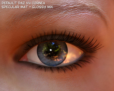

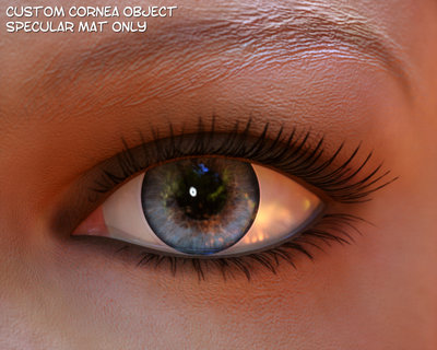

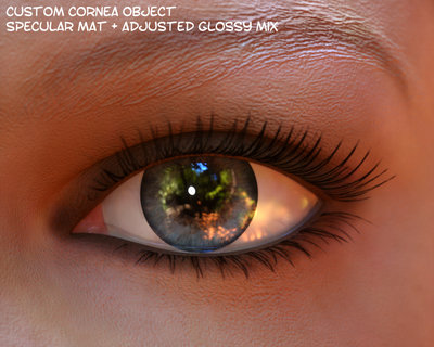

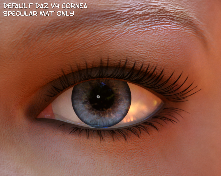

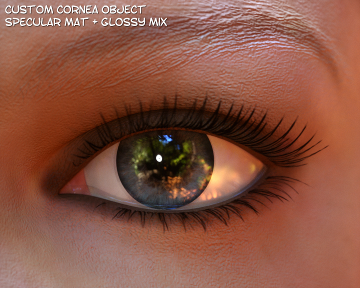

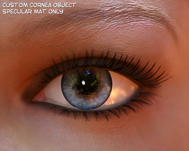

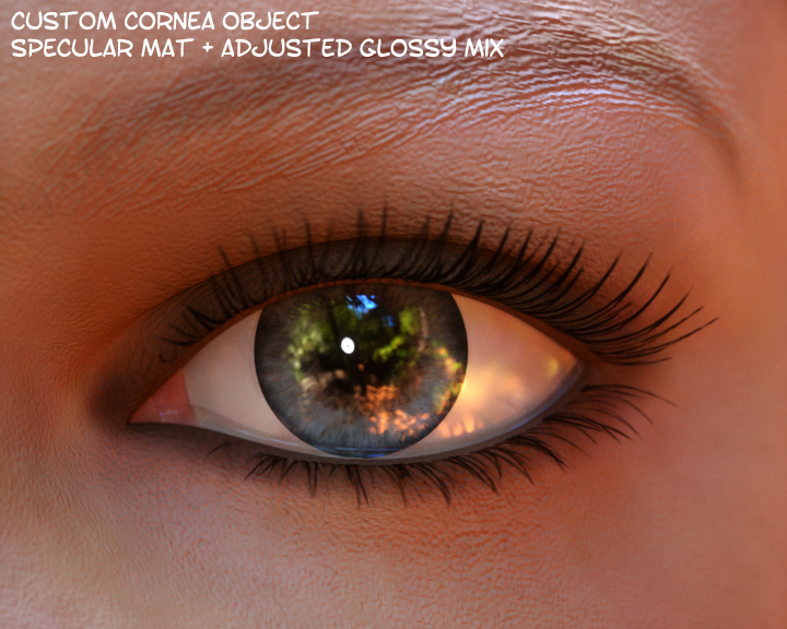

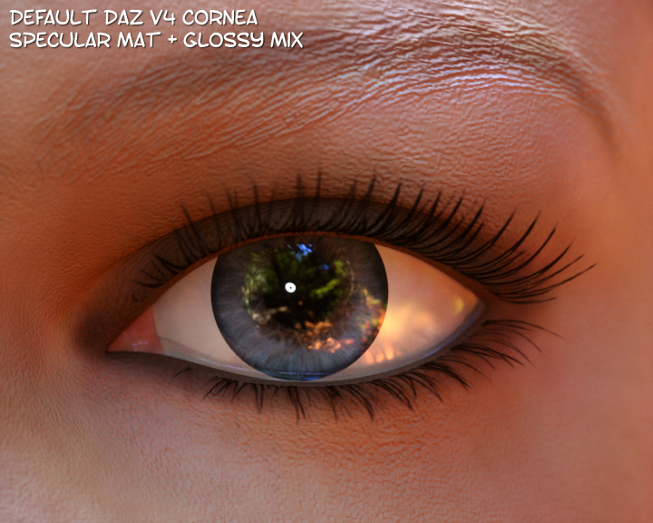

Did some experiments with the materials this morning and I also created a custom cornea object which actually has some depth and here are some comparison images.
Same scene and light/camera setup, PMC kernel and 10k s/px. Default DAZ Victoria 4 figure was used with default maps. Sclera map is default so it lacks details (it just has my custom glossy mat attached to it but the diffuse channel in it is default texture) as I focused on the cornea/iris/pupil. Free Topanga Forrest HDR map was used for the atmosphere plus one ring mesh light (I know I suck at putting lights to the scene) ;)
The custom cornea gives more of the lens effect to the iris and with the mix material it can get sharper reflections. The default cornea with the mix material gets sharper reflections too but there is no lens effect on the iris.
Adjusting the glossy material in the mix (opacity) affects the wash/desaturation effect on the iris.
I would say that if no extreme closeups are required then the default cornea with the spec+glossy mix material give best results. And for very high resolution images/extreme closeups then adjusted eye geometry is also required - where all this applies to the DAZ Generation 4 figures. I did not try it with Genesis or Genesis 2 but I suspect the results to be quite similar.

birdovous wrote:Did some experiments with the materials this morning and I also created a custom cornea object which actually has some depth and here are some comparison images.
