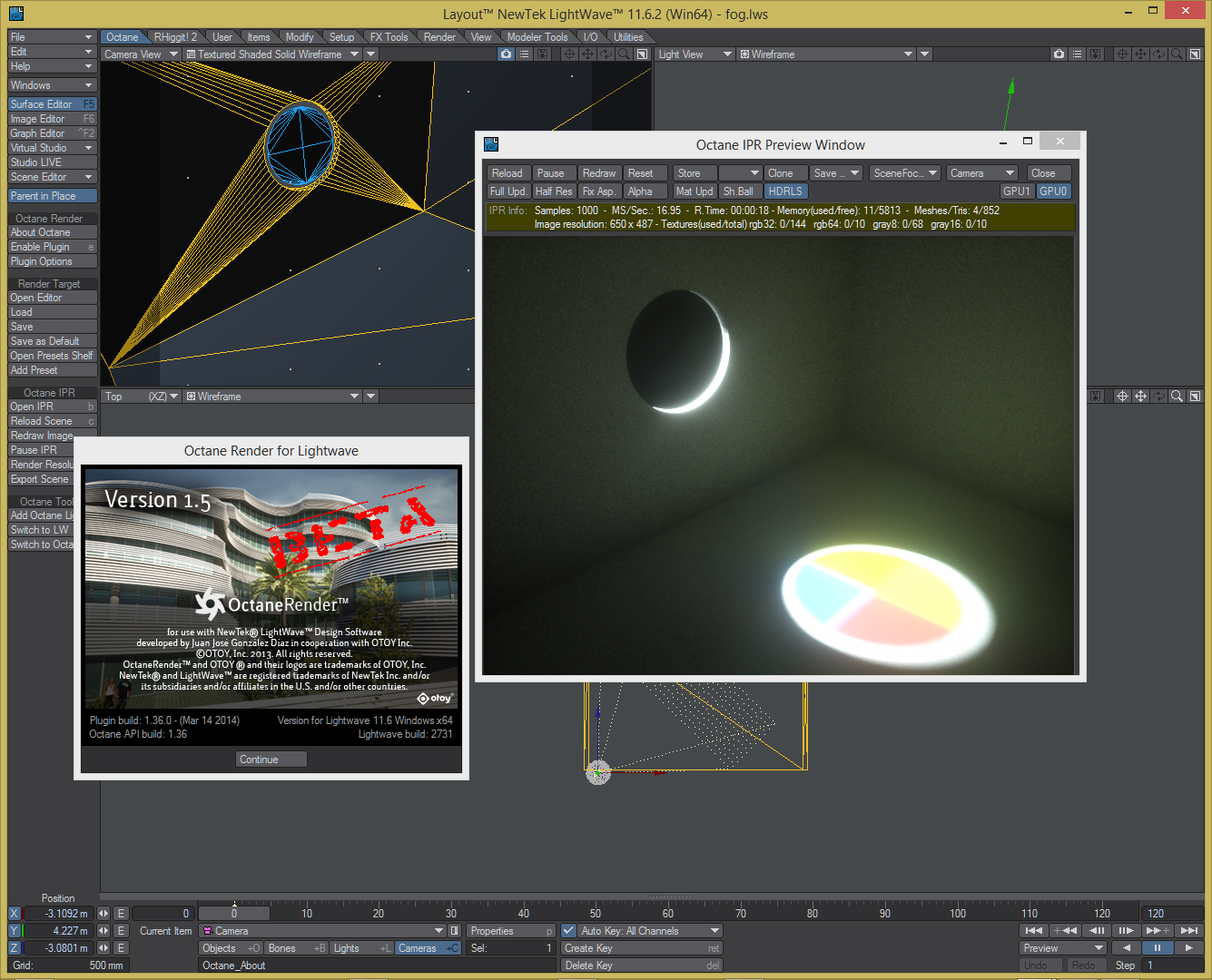

UnCommonGrafx wrote: Is it a bug that your fog scene no longer works?
Here it works fine. What's your problem with that scene?

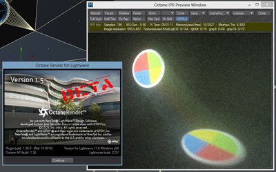

gordonrobb wrote:Got a slight niggle with HDRS - when I use light paint, the 'reflect' mode acts like the 'rim' mode (the light appears behind the object.
Can you duplicate that?
True, I have found the problem. Currently to work with HDRLS and Octane you need to have at least one viewport in Layout set to "Shaded Solid" or "Textured Shaded Solid". If you have all your viewports in "Wireframe" mode, Layout doesn't have the objects normals computed and the picking algorithm fails.
So the workaround is easy, in your scene switch the display mode of the viewport to "Shaded Solid" for example and done.
I am going to try to fix this problem, if possible. Thanks for report it.
-Juanjo
-Juanjo
I'll download the file again but none of the scenes I had setup to use this work.
I will go back through things to check but this what I get:
Just to add, since the betas, I have lost this functionality.

UnCommonGrafx wrote: Just to add, since the betas, I have lost this functionality.
Are you sure that you have the last Octane.dll and Octane.dat files inside your LW/bin folder? ... here all works fine. Anybody else have this problem?

UnCommonGrafx wrote:As always, thanks for the update.
I just wanted to confirm that the fog scene is working fine for me. I hope you sort it out.
Win10 Pro / Ryzen 5950X / 128GB / RTX 4090 / MODO
"I am the resurrection, and the life: he that believeth in me, though he were dead, yet shall he live" - Jesus Christ
UnCommonGrafx
Posts: 199
Joined: Wed Mar 13, 2013 9:14 pm
Thanks Funk, Juanjo,
One asks to make sure all is right. I have something amiss apparently.
I shall endeavor to find the problem.
Thanks for the info.
