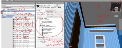

Hi kwaikeong1402,
Here is the 4 steps that you need to understand to create the light fromm geometry.
1. create a box or geometry.
2. create emitter material using autocad material editor
3. assign the material to the geometry
4. change material at settings. material should be diffuse with emission properties.
Let me know if this helps.
steps in creating geometry lights

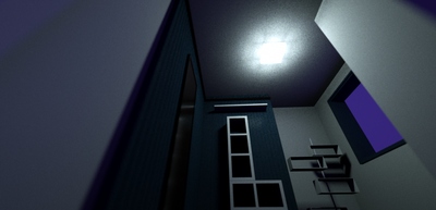

result
result

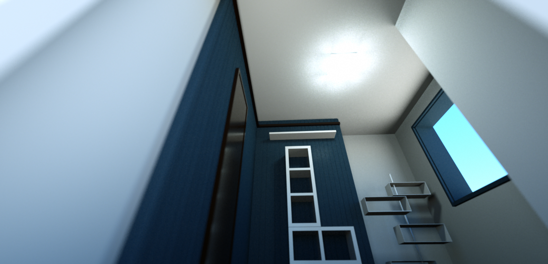

another test
another test

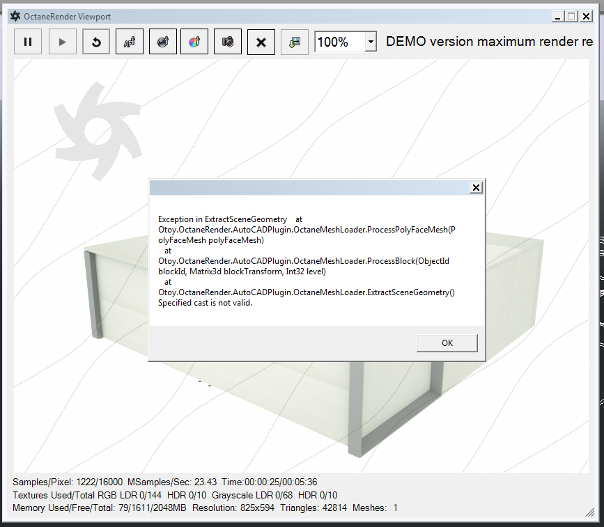

Kindly refer to the attachment file. Is it this render not support polyfacemech? What should I do now. :o
Thank you!

Hi
There is more info on PolyFaceMeshes is at http://render.otoy.com/forum/viewtopic.php?f=72&t=38976. In summary, AutoCAD 2014 does not appear to support accessing the geometry information for PolyFaceMeshes. From memory - it does work on AutoCAD 2013 - but I have not double-checked to confirm that. The latest version of the plugin will load the scene into the Octane Viewport excluding the PolyFaceMesh. So if you have PolyFaceMesh objects, convert them to solids or surfaces if you need to render them in the Octane plugin.
