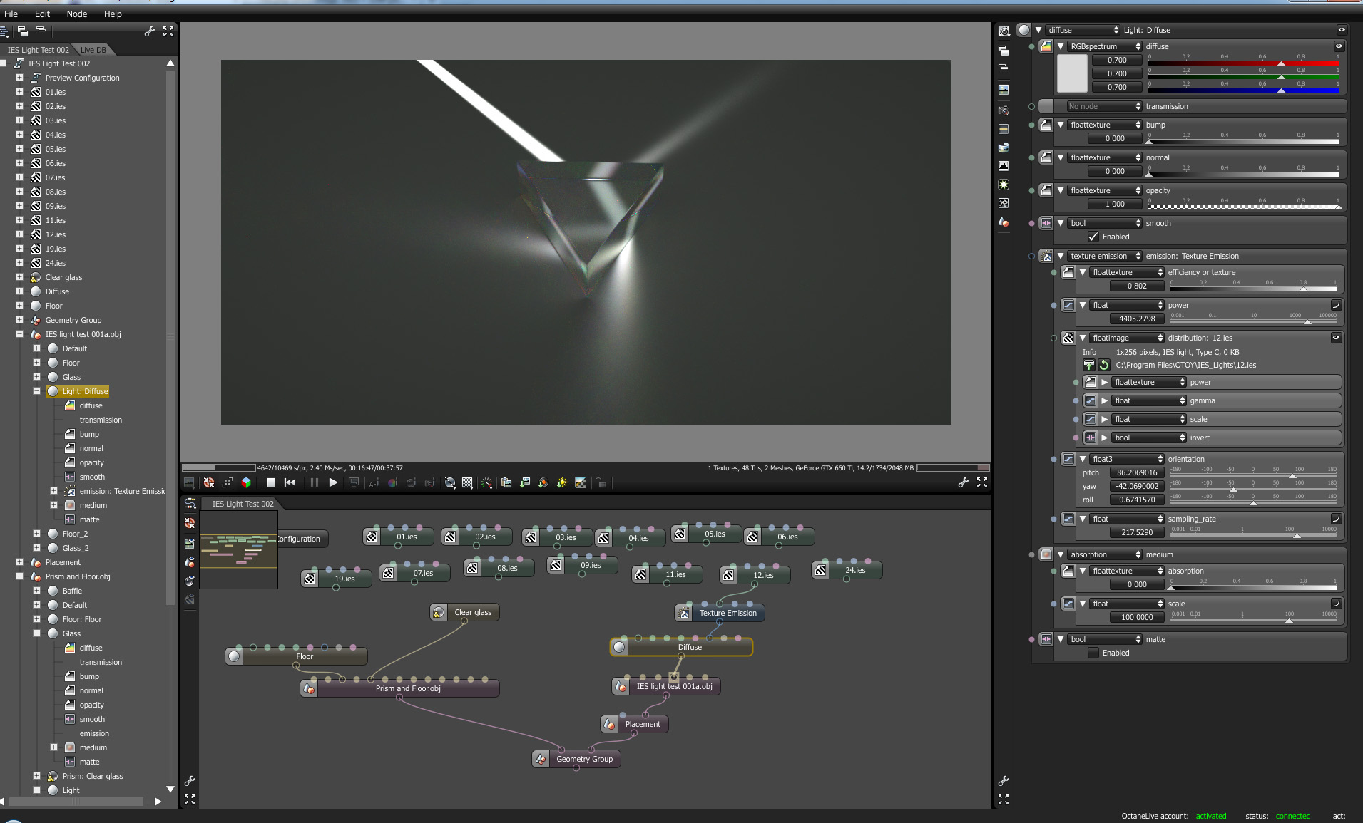

Try reducing your IOR a little and increasing your light intensity/efficiency.

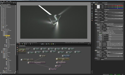

Hi Gordon, I've implemented your suggestions but I'm still struggling I'm afraid. This isn't fully rendered out but I don't see it differentiating the colours. If you could see your way clear to posting some files I'd be very grateful. Thanks, David

The beam may be invisible inside the prism because the prism shadows the floor, and the light hitting the bottom of the prism undergoes total internal reflection. If the beam needs to be visible on the floor inside the prism, the prism should touch the ground, and you should leave out the bottom plane of the prism.

Thanks Roeland for confirming that there shouldn't be a gap between the prism and the floor. My last render, above, shows the beam fine. I'm guessing that the bottom poly was invisible due to being one-sided and flipped facing down. I wouldn't have known that removing the bottom poly is advised, useful to know that if I ever needed to have a gap.
Thanks both, David

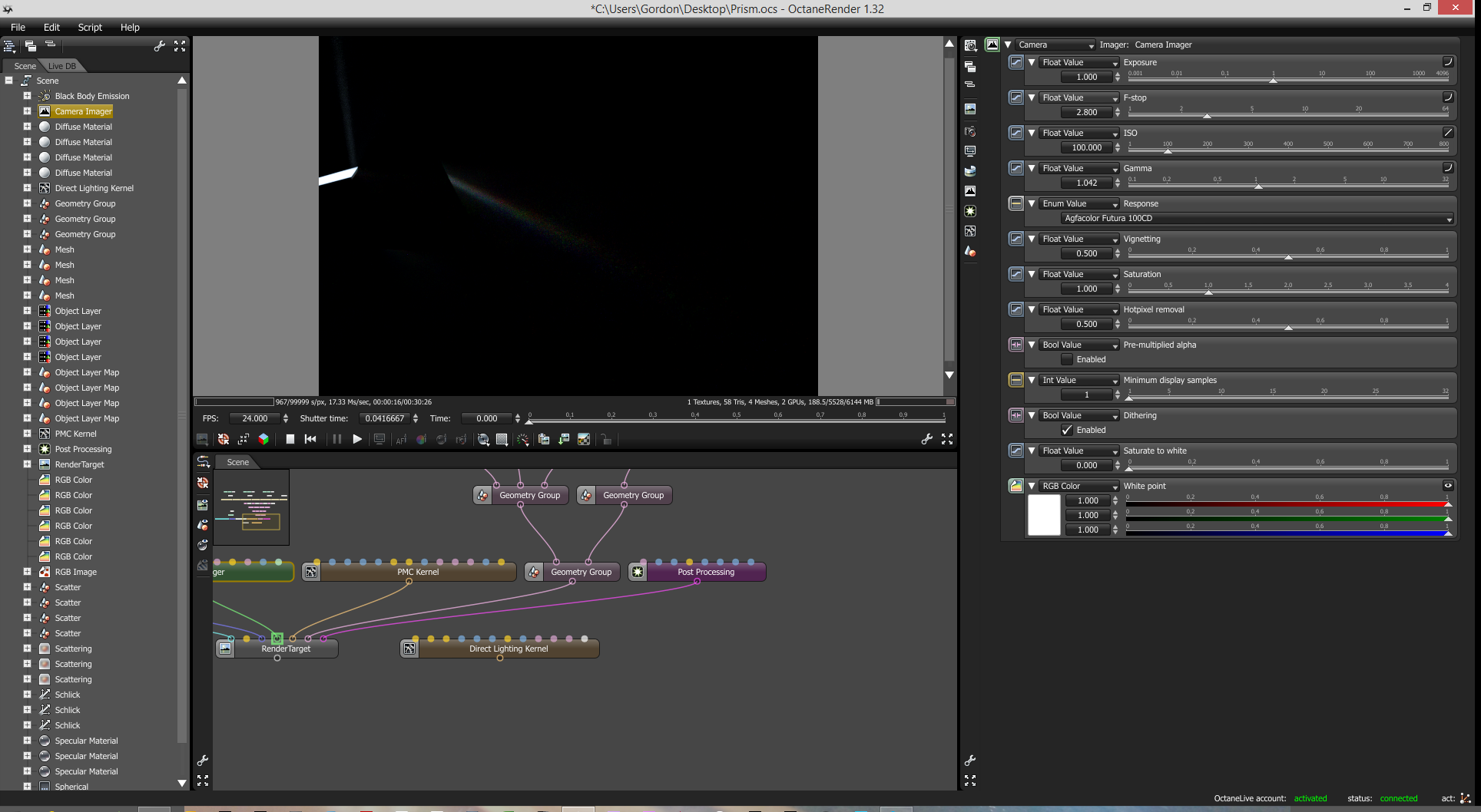

That's weird. Attached is a picture of that file loaded in Standalone. You using the latest version? You have unzipped it I take it :)
