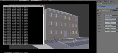

I am having a currently having an in issue in regards to saving with an earlier version of the Blender-Octane program (1.30). Now when I open this in 1.33 it just comes up with the "error: check console for more messages". I am currently working on a major client project so it couldn't have really come at a worse time! :O
Is this due to the way I have installed the new plugin and programs or does this happen with files from the last build? I would love some help!

Sixthlaw wrote:I am currently working on a major client project so it couldn't have really come at a worse time! :O
Never ever use the testing major versions of any software on currently worked urgent projects.
Sixthlaw wrote:when I open this in 1.33 it just comes up with the "error: check console for more messages"
Please, check console for more messages.

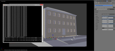

Hey Jimstar,
Thanks for the quick reply.
I understand that I shouldn't be using the Dev version for Projects - I would also like to mention how awesome I think your work is and my massive appreciation for your contribution you have made to octane! More people post problems here than appreciation, so that's mine!
In regards to the error Message, I have attached it to this post. Just to be clear, the entire scene was working fine in the previous version and all textures/materials were created using OCTANE texture and material nodes. All objects in the scene are still using those nodes though, which makes me confused as to why its producing this error...'
have I missed something?

These warning messages are not errors.;) They are just for your convenience, to let you know that not all materials in the scene are Octane nodes... It does not interfere with render, just default material will be rendered in this case.
So, the only error here - is in the second screenshot at bottom. Octane complains here that it can't find the image files of textures in these paths. So, just check that the needed image files are present in these folders.
