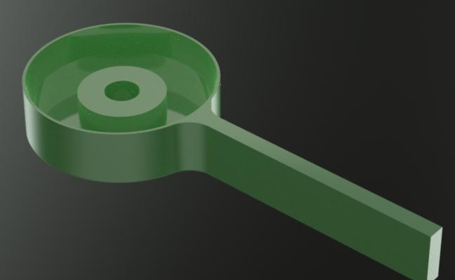

Here are the files:
One is the IGES export from PRO/E
One is the SLP export from PRO/E
One is the OBJ export from Blender
I can check them all but SLP using FreeCAD. I think SLP output from PRO/E is missing normals data. I hope I'm wrong.
I'll check importing STL format.
Thanks for any help.
Daniele

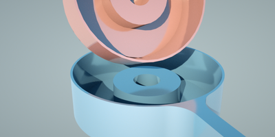

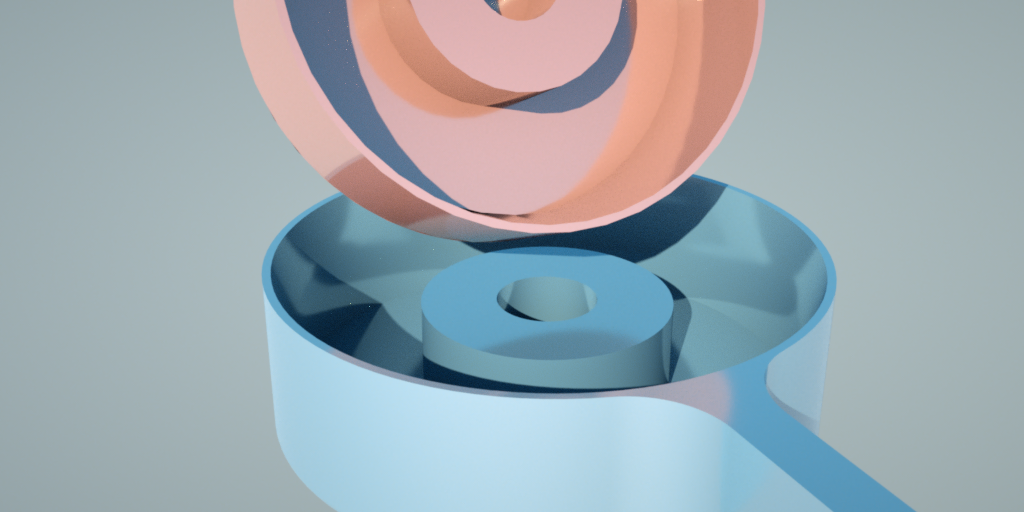

Hi, i test the .obj and the .slp file in blender and the slp mesh is much better.
You have to set smooth in blender an use the edge split modifier, also "Apply all Modifier" during export from blender to .obj.
Cheers mib
Edit: .slp is blue
Cheers mib
Edit: .slp is blue

Many thanks for your test !
I'm not in front of the O.R. computer but... this is exactly what I done. (At least it seems).
Edge split to 10 (or similar value) plus 'set smooth'. In Blender I could see the quality/quantity of the smooth changing depending on edge split value.
Actually I didn't apply the e.s. modifier... seems a stupid question... do I have to apply it or it's enough to see it in the modifier's stack ?
I'll try later. Anyway thanks again for your time.

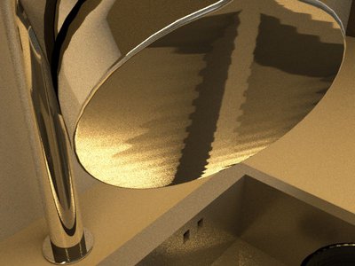

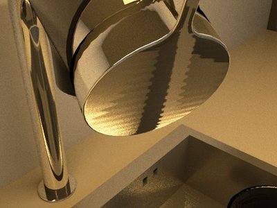

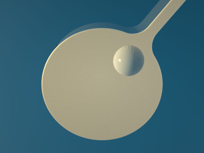

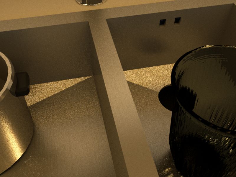

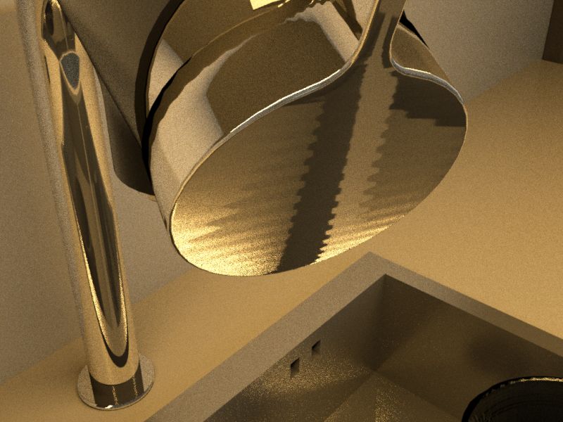

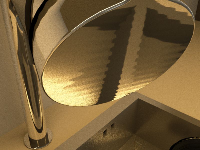

The only remaining problem is the strange reflection i've got in my scene.
I enclosed some pictures of the same scene with different zooming. The image reflected on the flat surface has to be the same, but I obtain a somehow irregular picture depending also on the zoom.
Using a simple scene, the part + sphere, the reflection is good (reflb6.jpg)
Any hints ?
Any hints ?

Any idea on the strange reflection ?
