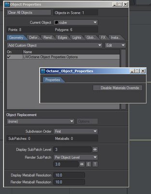

BorisGoreta wrote:clay is cool
what is color clay mode ?
can you please make that clay disregards specular materials with fake shadows which are windows so that in clay mode sun can shine through ?
Color clay mode is the same that the gray one, but it uses the diffuse color or texture to shade the objects.
Clay mode is a internal Octane rendering mode that can't exclude objects. You are going to need to disable this objects in the scene editor if you don't want to see them, or use the plugin override function ... you can add the octane custom obeject plugin to the transparent objects to exclude them from the materials override and keep the specular material with fake shadows.
-Juanjo

Thanks for explaining but I don't understand this last bit. What is octane custom object plugin ?
-Juanjo

juanjgon
Posts: 8867
Location: Spain
BorisGoreta wrote:Thanks for explaining but I don't understand this last bit. What is octane custom object plugin ?
-Juanjo
There is a custom object plugin that store Octane rendering parameters for each object. Currently you only have one option, that disable the materials override for this object.
-Juanjo
