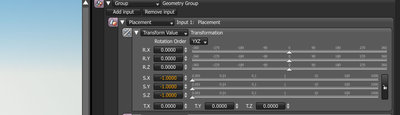

Allow negative values for the object scale - thank you for this and for all of your hard work.
I just tested the negative scaling values. Surprisingly I couldn't see negative values in SX SY SZ so I input them manually and it works. These values appear as orange. IMO this is unintuitive. What about such solutions:
1. SX SY SZ sliders have negative values on LHS from 0, or:
2. Add three extra boolean options/checkboxes: mirror on X, Y, Z.
Wow, a big thank you for negative scaling !
It is the first thing that I checked in 1.25 and I asked yesterday what happened to this so needed feature !
I have just tried it on the placement node of a half of a symetrical victorian building, and it works fine ! It allows to divide by two the amount of required memory for symetrical objects. Very important when you have old hardware.
Thanks again !
Thanks again !
