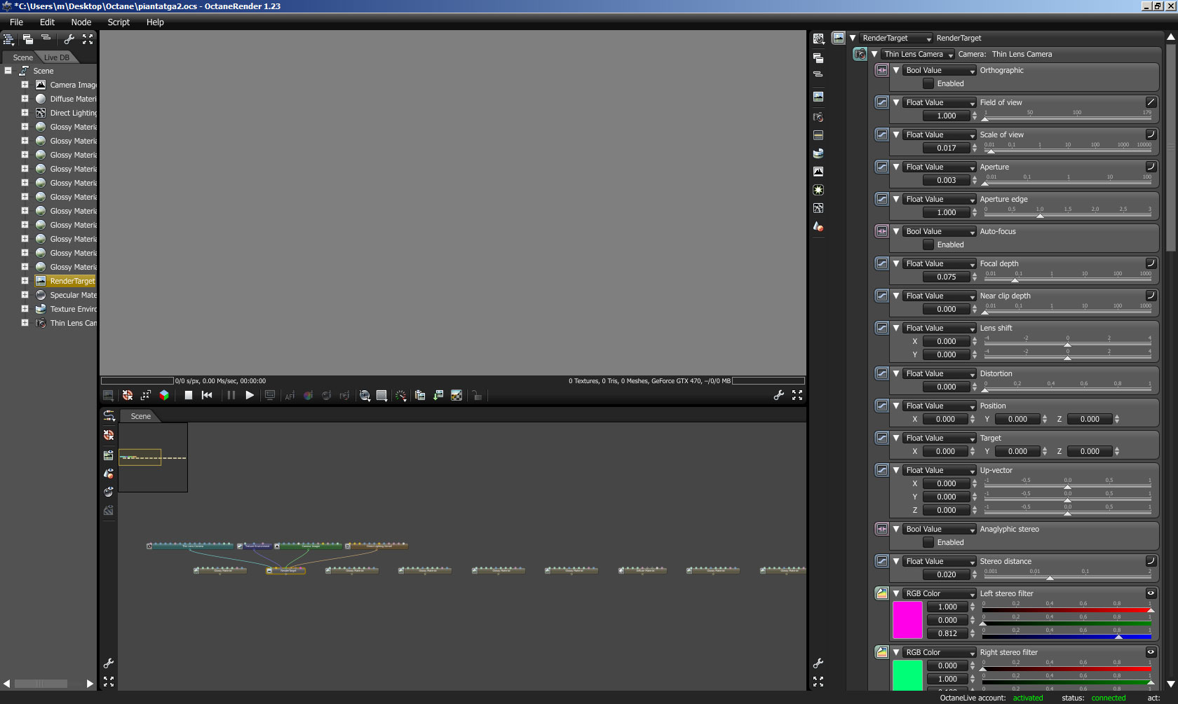

Paul, is the Export to OCS actually work as it should? I mean, I did try to export it to OCS but this is as far as I go, other exporter does open the scene by itself while on this installer it does not, BUT is not the issue, more like that It does not seems to render the scene at all, only materials and nodes seems disconnected? clicking on the render target does nothing...
edit: upgrade to Octane 1.27 works BUT camera coords seems lost AND navigating to recover camera position make octane hang...

justix wrote:Paul, is the Export to OCS actually work as it should? I mean, I did try to export it to OCS but this is as far as I go, other exporter does open the scene by itself while on this installer it does not, BUT is not the issue, more like that It does not seems to render the scene at all, only materials and nodes seems disconnected? clicking on the render target does nothing...
it seems that you have not exported the mesh node.. :( in the 1.25 it works fine...
Until things settle down with Octane Standalone - I think you will need to open the exported OCS file in the same version of Octane Standalone as the Rhino plugin. So export from the 1.25 version of the Rhino plugin and import into Octane Standalone 1.25. This /should/ work. If it does not, pls let me know the details.
