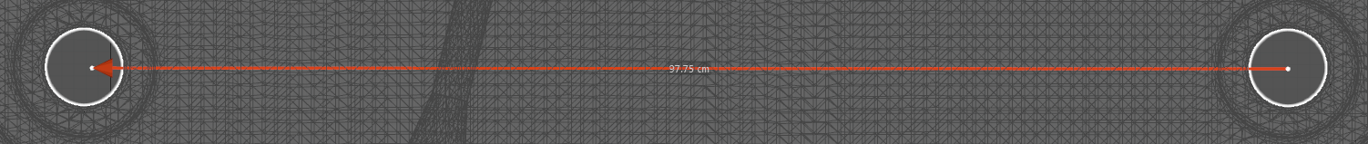

This one seems to work fine. Just your measurement seems a bit off, the distance between the two holes is around 0.984 inch, rather than .9775 inch. If you switch to an orthographic camera and via the toolbar set the camera to the top view, then the distance between the left and right side of the image is exactly equal to the value in the "Scale of view" input of the camera. If you set this to .9775 you can clearly see the distance between the holes is slightly bigger.

Then the problem is in Octane when it imports the image. I have taken the mesh and imported it into ProEngineer to check its size and the value is definitely .9775. Therefore, Octane must be rounding the mesh down or doing something else to cause it to be off.

Then ProEngineer is a bit off. I checked in Cinema 4D as well, and if you set a measure with a length of .9775 (the object was imported in meters) then you see that one of the end points of the measure is off-center.
