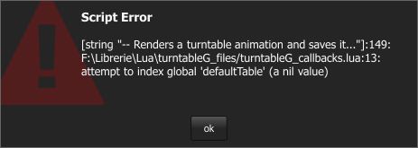

wow. thanks grimm, the render target popup is fantastic :)
i've got this error message if i click the load button:
maybe because my lua folder is on an external hd :roll:

Hi bepeg4d,
Have you clicked the save default button before this? I need to add a check to the script that makes sure that there is a file to load first and popup an error message. Sorry about that.
Jason
