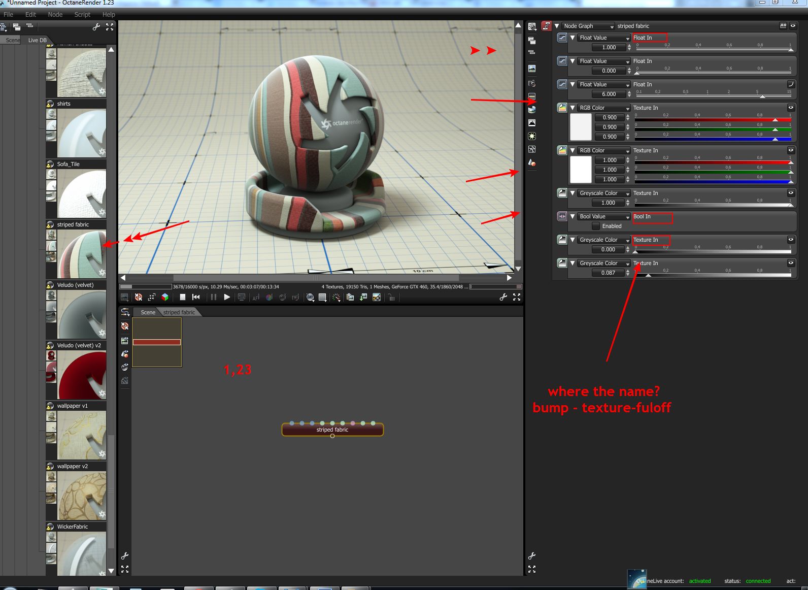

where the name Live-DB? Octane render 1.23

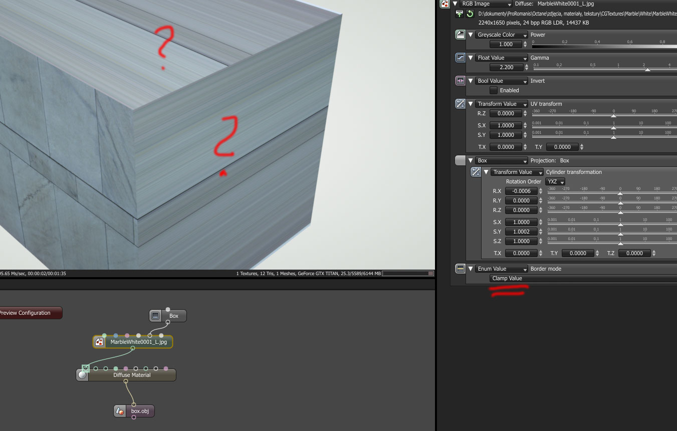

A bug? - when I press arrows and hold a mouse button for changing e.g., SX, SY, TX, ... values they are changed only by one incremental value (i.e. 0.0001).
BTW Where is the function to mirror the image texture?
Oh I see - in the border modesmicha wrote:BTW Where is the function to mirror the image texture?

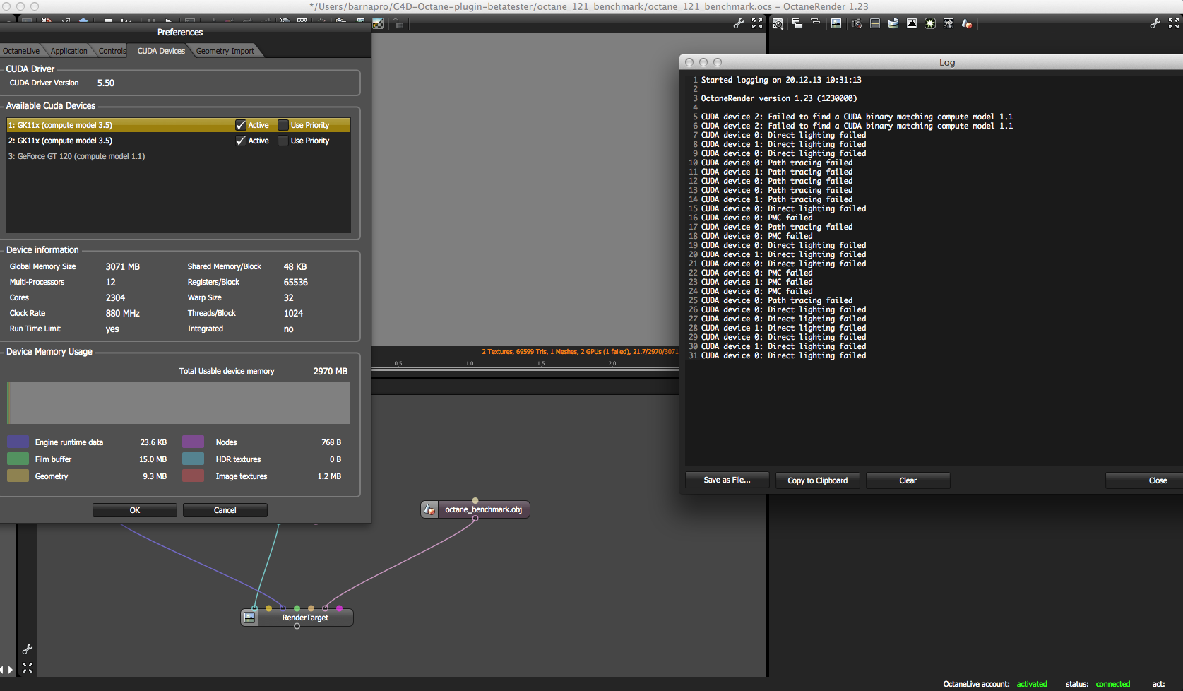

unfortunately under os x it always failed to charge any kind of geometry, ocs, obj and alembic

We forgot to mention it in the change list: You have to move the mouse up or down to scroll through the numbers and by pressing SHIFT it increments/decrements 10x faster and by pressing CTRL it increments/decrements 100x faster.smicha wrote:Thanks for the update.
It's a new image wrap mode (which you find in the image texture nodes).BTW Where is the function to mirror the image texture?
Works like a charm! Much better than in 1.22abstrax wrote:You have to move the mouse up or down to scroll through the numbers and by pressing SHIFT it increments/decrements 10x faster and by pressing CTRL it increments/decrements 100x faster.

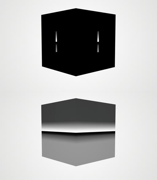

BTW - when I choose "CLAMP VALUE" in the border mode mode I see kind of stretched texture over the area where the box is white - see the attachment. Could you please write something more how the clamp value works (any link if it's been already described)?
It repeats the image pixels which are at the edges of the image.smicha wrote:Works like a charm! Much better than in 1.22abstrax wrote:You have to move the mouse up or down to scroll through the numbers and by pressing SHIFT it increments/decrements 10x faster and by pressing CTRL it increments/decrements 100x faster.![]()
So if your image has a red border, the clamp value should make the rest red.

Face, shall I use a PNG with transparent border to get a single (non-tiled) image? Sorry for a dumb question, but I don't get the idea of this "clamp value".face wrote:It repeats the image pixels which are at the edges of the image.smicha wrote:Works like a charm! Much better than in 1.22abstrax wrote:You have to move the mouse up or down to scroll through the numbers and by pressing SHIFT it increments/decrements 10x faster and by pressing CTRL it increments/decrements 100x faster.![]()
face
You can use it as an example when you have a gradient.smicha wrote: Face, shall I use a PNG with transparent border to get a single (non-tiled) image? Sorry for a dumb question, but I don't get the idea of this "clamp value".
