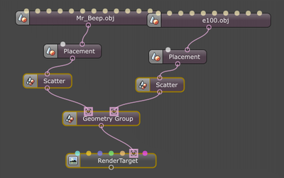

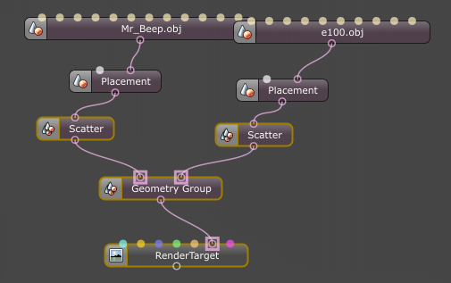

Just so that I understand this correctly. For example given the next selection:
selected nodes
selected nodes
Right mouse on the selection and then "script" would then generate something like this in the editor:
Code: Select all
-- auto-generated code
local renderTarget = octane.lua.magic()
local geometryGroup = octane.lua.magic()
local scatter1 = octane.lua.magic()
local scatter2 = octane.lua.magic()
So basically it generates a code template from the selected nodes. I guess it's up to us to decide what the magic will be ;)
Is this what you guys meant?
thanks,
Thomas
