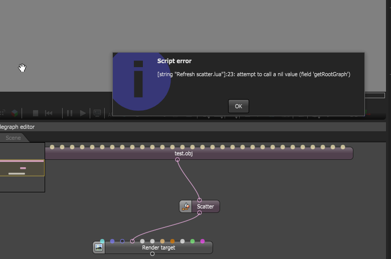

is this script still working for the latest version?
i get the following script error

Posts: 10514
very old script and discussion, you need to change the last line in the following way, to make it works again with latest Octane’s versions:
Code: Select all
updateItem(octane.project.getSceneGraph(), octane.NT_GEO_SCATTER, reloadScatter)
