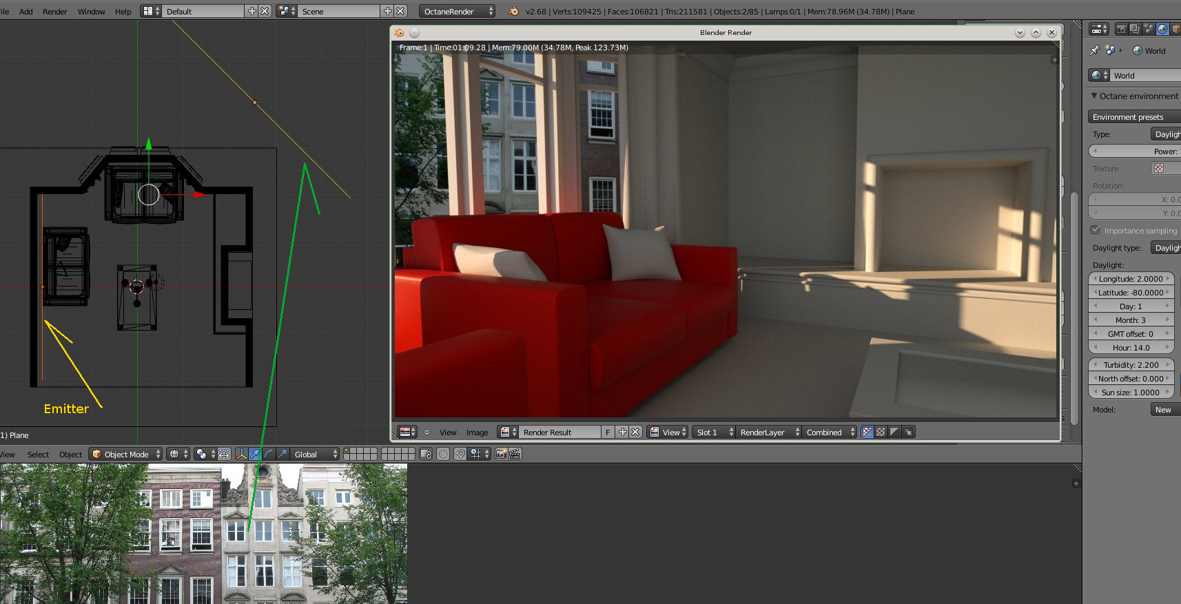

Hi, I think you use a environment map to light the scene, this emits not enough light.
I use sunlight and a background map for the street and add a big emitter behind the camera to add more light to the scene.
DL diffuse render kernel, render time 1 minute.

Cool..! That looks really good, amazing for 1min render! I may have forgotten to mention this but the first images I rendered were not using an environment image, the other houses in the street were actual geometry and I removed them from the obj when I exported it... I only used the sunlight with the map coordinates set for my location which I am trying to simulate.
So you believe that I should be adding an emitting panel behind the camera to boost light..? Will this affect realism of light path and shadow casting? Im currently rendering the scene at a very low resolution using the PT kernel @ X8 for a total or 20K samples and it is estimated to take 1:20hrs on my iMac's GTX680... I have not tried it on my GTX780 yet...

The hardest thing for a render engine is a room with one window,
you can help the engine with extra lights.
The emitter is nearly as big as the wall behind the camera to lit the dark areas, front of sofa for example.
It helps also for PT kernel but as you see DL diffuse is also realistic.
Remember, this is 1000 samples and I think with 2000 it is really clean.
20000 is way to much for such a scene.
I can send you the Octane file tomorrow , you cant save but you can open an .ocs file.

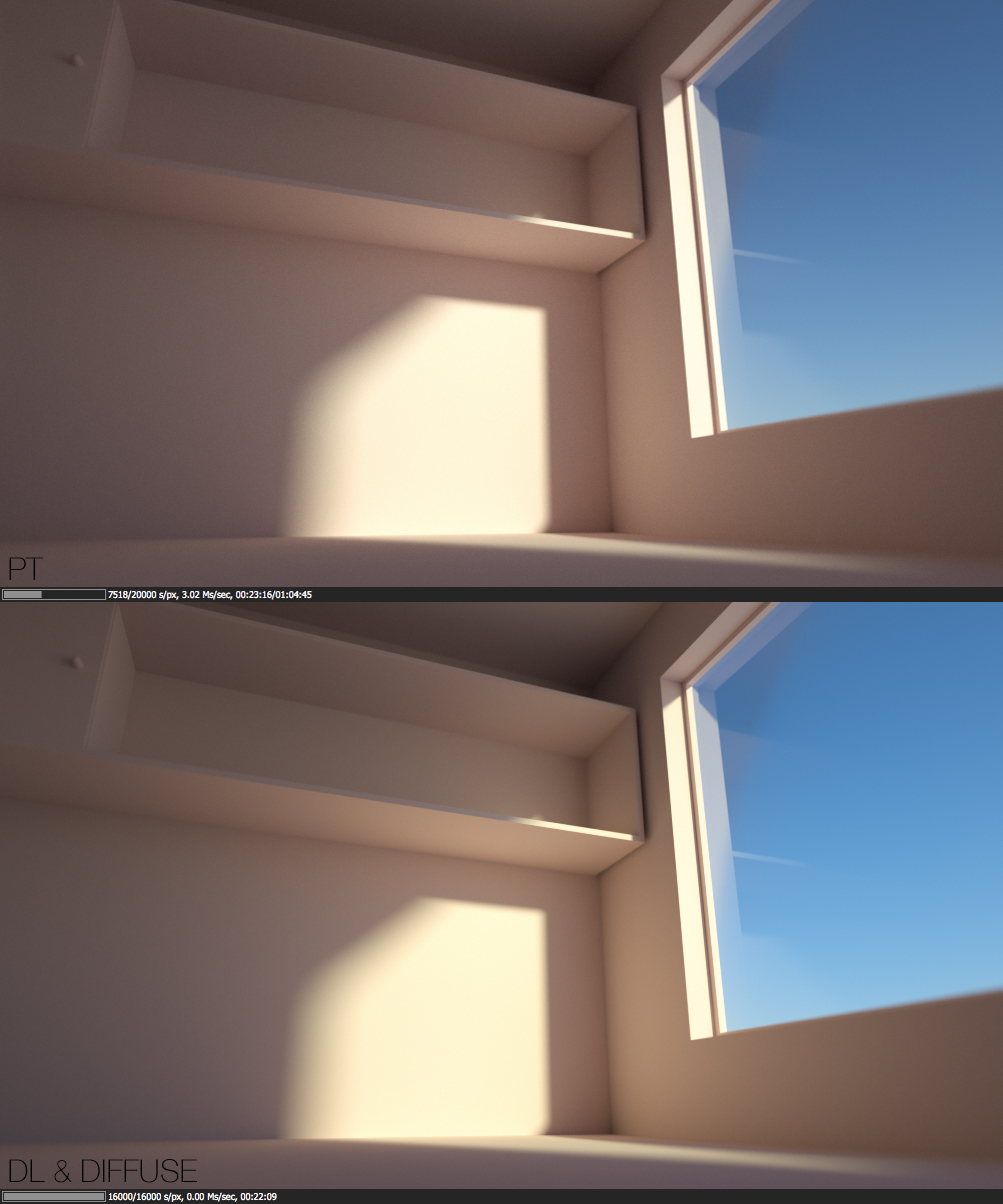

I was rendering a test scene I quickly setup, and I wanted to finish my troubleshooting before I loaded the test scene you sent me as I could not save what I was working on... I thought it might be beneficial to upload a comparison of the scene rendered with both Kernels that we have been talking about...
