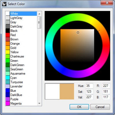

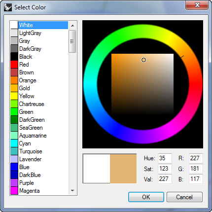

face_off wrote:
Is it possible to have octane standalone like color picker?
I don't think that is possible. I might be possible to use the Rhino color selection dialog though - is that something people want?
Paul
That would also be great.
Rhino Color picker.
Rhino Color picker.
Best Regards, Jitendra

Location: Brooklyn, NY, USA
I agree, having rhino's color picker would be more user friendly.
It's in the version I just posted. Much beter than the windows color selection dialog.
