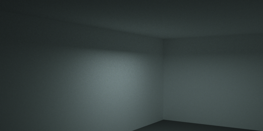

Spot the light ....
Simple room with no openings or lights ...
As suggested before - created a plane mesh in Blender to shine downwards (flipped). Then replaced the Revit studio light with the exported OBJ from Blender (Proxy). Set the material to Diffuse and emission as blackbody. Set the Opacity to 0.
ps I'll post the files if it helps? ...
Light_Panel_Test.zip
(3.64 MiB) Downloaded 492 times
You'll need to reload the Proxy file to suit your directory location. Select the Studio Light in Revit and with the Material selected change the Opacity back to 1 to see the mesh plane ...
