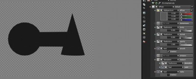

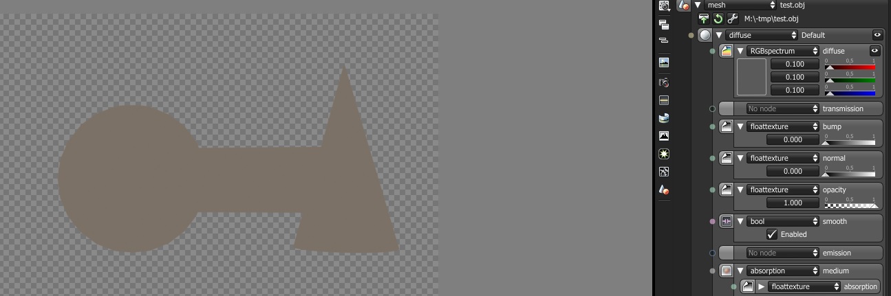

Yes ... I understand your issue. You want a color picker that support the Octane tone mapping functions to match the picked color with the color you get in the render after the tone mapping, but I am not sure if this is even possible.
But Octane Stanalone also show this behavior ... see this example, I set the Imager to gamma 2.2, film response Gold 200. A diffuse material with 0.1 gray in the node settings render a 0.48, 0.44, 0.40 color object. Doesn't match at all.
