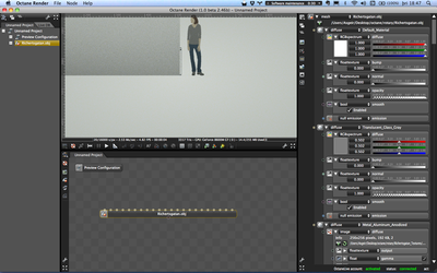

I have a problem.
I choose to export the camera in Octane exporter but in Octane I get a totally different view.
Can I fix this? Am I doing something wrong?
i'm using MacOs 10.6.8 and Sketchup 8

Do you get any error messages in the SKP's Ruby Console OR Octane as it loads...
The camera should be overwritten by the new export settings...
Weird? Is that 2d figure in your SKP ?
If the SKP is small enough [or zippable] can you PM it to me so I can test it...
