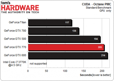

You cant really compare Titan/780 and the GTX 600 series.
The Titan/780 is crippled Tesla GPU , crippled mean for example reduced Double-Precision performance.
But this dosen´t matter for Octane performance.
The GTX 770 is a rebranded GTX 680 GK104 Kepler, all a bit confusing.
Tesla 2070 6GB is a "Pro" card for 24/7 usage with ECC VRam.
So Tesla is slower, less memory and 3000 $ compare to 1000 $.With ECC on, a portion of the dedicated memory is used for ECC bits, so the available user memory is reduced by 12.5%. (e.g. 3 GB total memory yields 2.625 GB of user available memory.)
If you don´t really need 24 Hours 7 days full load Tesla makes no sense.
