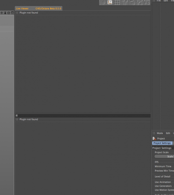

Are there some files missing in the 0.6.x R14 MacOS version?
Compared to 0.59 there was 'octane.dat' 'liboctane.dylib' which aren't there.
Also when I launch c4d it says plugin not found. see attached...

kristoph wrote:Are there some files missing in the 0.6.x R14 MacOS version?
as i said that this is a update. there is only partial files. please read link
http://render.otoy.com/forum/viewtopic.php?f=30&t=33334
