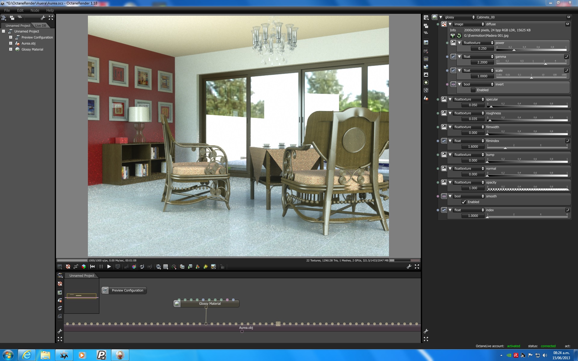

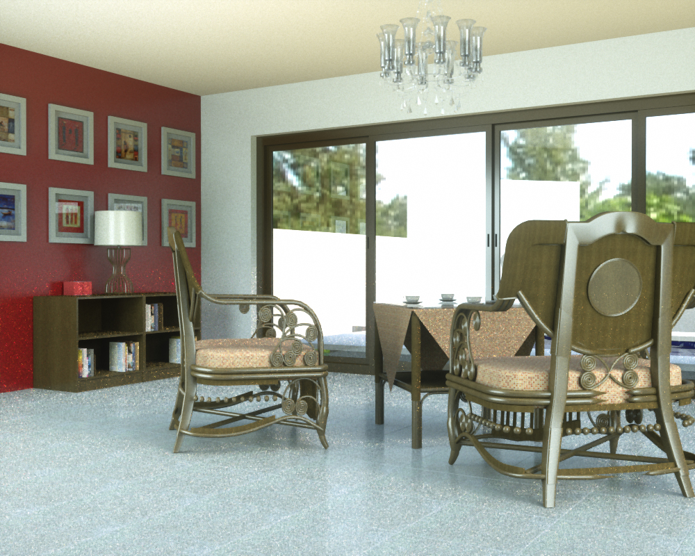

few observations !!
first the noise in the image, with the last versión 1.17 dosen't happen this, add image
second point the value index not change before i can did put 1.30 to 0, now minimun is 1, why ?
let me understand please
thank you
ahhh, the second image show in the glass window the background a pixel in the reflect, maybe a bug ?
t_3
Posts: 2871
mantra wrote:for 99.9% of customers
why do you know?
The obvious is that which is never seen until someone expresses it simply
abstrax
Posts: 5508
merid888 wrote:few observations !!
How does it look like in 1.17? Could you send us the scene please?
All index values between 0 and 1 produced the same behaviour: Turning off Fresnel and making the reflection 100% of the value that is defined by the specular texture. We set the minimum to 1, because in specular materials it has been 1 all the time, so we wanted to make the index of refraction consistent between glossy and specular materials.
thank you
What exactly do you mean? The background image isn't interpolated. Do you mean that?
