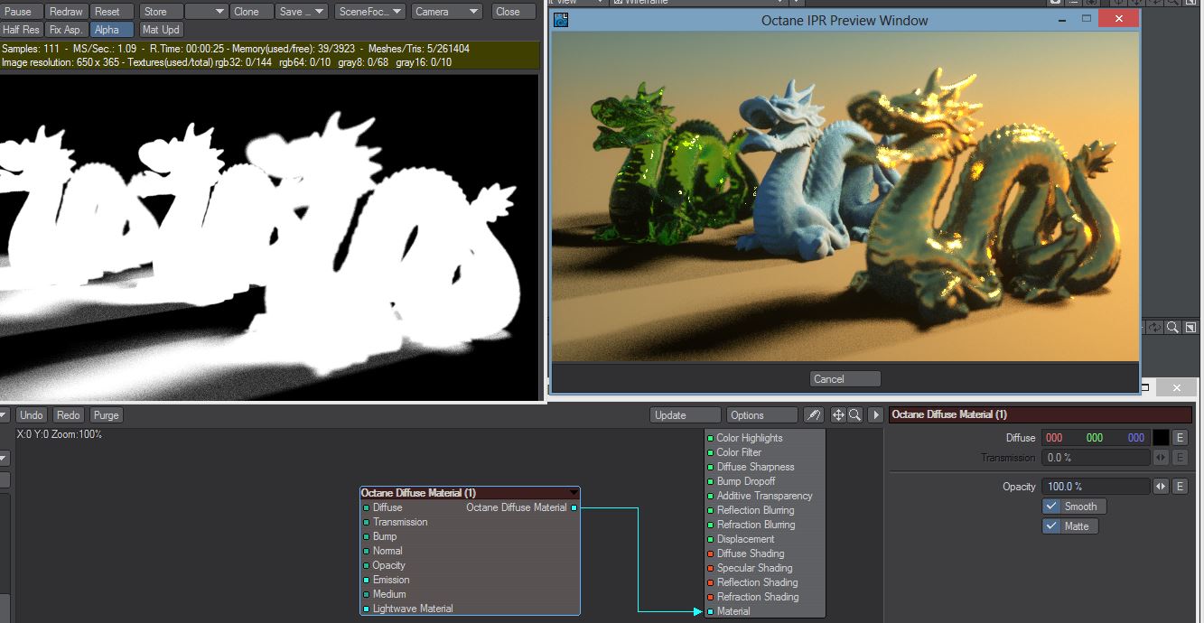

how do i get a shadow pass from octane render for lightwave?
I have a car on ground scene i just need render car and shadow and composite in after effects.
need help..

Make it Diffuse Material. Make Color Black 0,0,0. Check Matte.
And I think Enable Alpha Shadows in target... maybe I am wrong about
that part...
EDIT: or maybe you just want shadow... try to get everything rendered
as solid white except car shadow. Save as 24bit PNGs.. Use Multiply in AE.

i did switch ALpha shadow in target and applied diffuse to ground with Matt on but no shadow in output file!

You don't have opacity set to 0% do you.. you don't want that...
Are you looking at rendered alpha.. depending on what (and how)
you are rendering, sometimes saving the alpha as 24bit and using
that is the way to go.. crap I have to run out door.. good luck..

aw1 wrote:i did switch ALpha shadow in target and applied diffuse to ground with Matt on but no shadow in output file!
The shadow should be in the alpha channel to allow compositing, using the matte option for the floor object is the way to get this effect.
