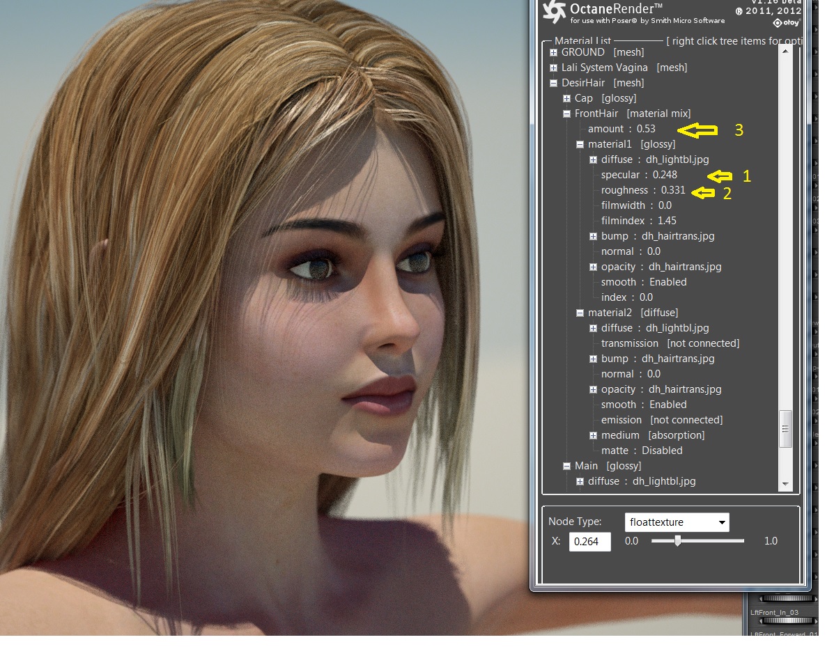

First of all - it all really depends on the hair textures and transparency maps. Some are better as others.
here is a screencap of how you are able to change the appearance of the hair or the render quality. I have not done anything on the skin of the figure, just the hair. It is just to give you an idea on how to do it.
The front hair here is the only one I changed for this example to show you the difference.
1 is the amount of blurriness of the light reflection.
2 is the how much light should be reflected
3 is how strong the overal effect is
The exact values are a matter of experimentation - it depends on your own ideas on how it should look
How do you set it up?
Go to the hair material in the plugin
Copy the material (righ click Copy gloss)
Change the material node type to Mix Material
Now paste the copied gloss material into each of the texture nodes of the Mix Material
Now change the node type of the second texture to diffuse
After this you have the 1,2 and 3 of the screen cap
The next step is here to change the medium in the diffuse part to scattering.
Start with scattering at 0.5 and scale to 1.0 - now experiment to see the effect.
Again, the values are not set in stone - it depends on your own taste, camera angle, light setup and texture material. What we are trying to doing here is to give the appearance if hair to a flat plane, so it is an approximation
Hope this helps

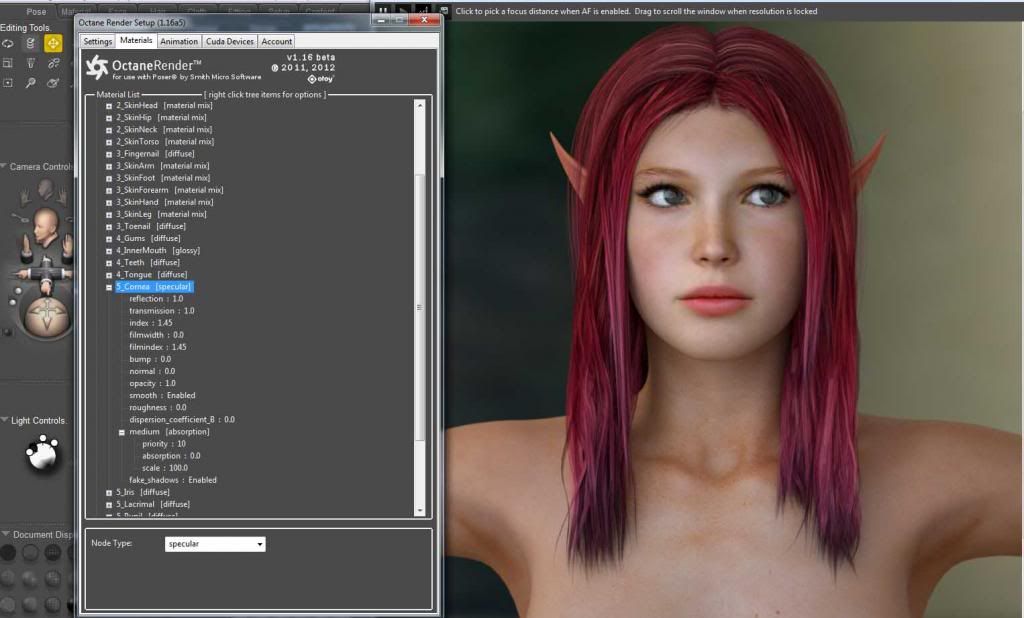

Any chance you can share your eye node settings, I love the look you have in the picture you posted in this thread, thanks

bpzen i found i had this file on labtop hope it helps
