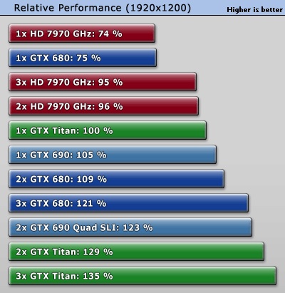

Overclocked TITAN is at least as fast or faster than 690, draw less power, has more vram, and so on.
BTW - those bars are false. If 1xTITAN=100%, then 2xTITANs=200% for Octane performance. Their performance should scale linearly, 4xTITANs=400%.

smicha wrote:Overclocked TITAN is at least as fast or faster than 690, draw less power, has more vram, and so on.
PS. GTX 780 is 10% slower than TITAN (3GB vram).
Yeah, agree & best part is that You get all that for the same price /almost.
well, he has the information, but..I assume, he looked into gaming type review - that's all =)
.."relative performance" ? sorry, wtf is that? =DDD..based on what workloads? etc..

This graph is totally bogus.
Octane scales 100% with every new card added.
