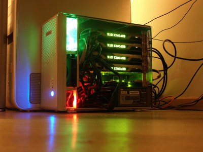

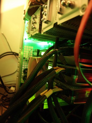

I have 3 TITANs in the main case and 4 TITANs in the Netstor expansion box so it is not 8 but 7 cards. I really recommend the Netstor box because it works without any problems at all. Windows recognizes all 7 cards and scaling is linear, Octane works exactly 7 times faster then with a single TITAN.
This is on Windows 8.1.

nice rig!
but with $2200 I buy a second workstation:
TJ11
1500w PSU
cpu
24gb
2 ssd
mb
Windows 7 Pro
