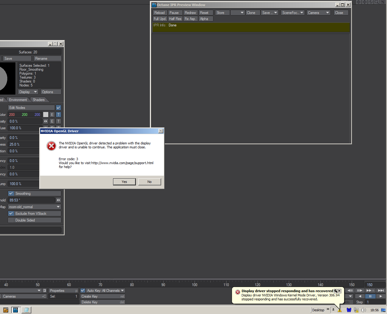

I think I found a bug here. See image.
This only happen twice, and it only happen when the Surface Editor window was open.
I left the PC for a few mins, screen goes black, then the crash window pops up.
Win 7 pro 64bit GTX780

NemesisCGI wrote:I think I found a bug here. See image.
It is hard to say. Usually this kind of crashes comes from system, drivers or hardware problems. If you have a scene that repeat this crash, please send it to me, or also you can enable the log file in the plugin options panel and send to me the log file, where sometime I can see the plugin or CUDA errors that cause the crash.
-Juanjo
