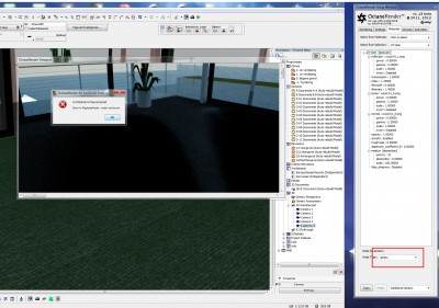

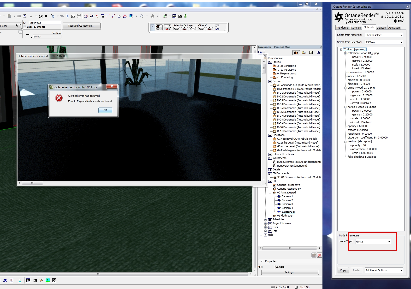

Hi Paul,
I get this message when trying to change the material node.
Am I doing something wrong or is something going wrong?
greetz, Jeroen
