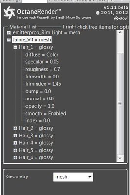

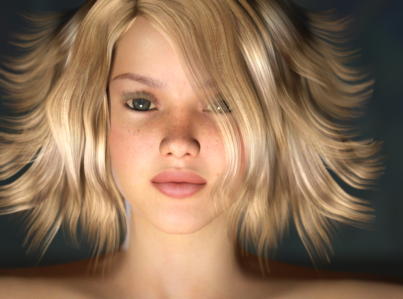

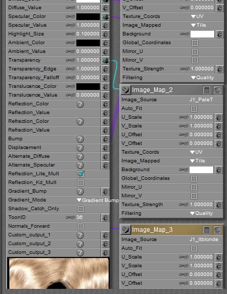

The hair is called "Jamie_V4 Hair". Here are the shots....I hope they help.
This is the hair rendered in Poser.

Pete, can you try right clicking Hair_1, Hair_2, etc and select "Reconvert from Poser" for each? Its possible the scene has just been saved with the blank material conversion.
Also, if oyu load the hair prop into a blank, new Poser scene and render in Octane, does it work correctly?
Paul

It looks like the image maps for diffuse and opacity didn't find their way into the Octane scene.
Can you try put them in by hand?
(changing the diffuse node to "image", put in the missing diffuse map of the hair part and changing the opacity node to "floatimage" and put in the trans.map of the hair part)

Success, at last. I don't know what happened exactly. Somehow the image maps in my V4 hair folder became unlinked to my materials....even in Poser renders. I decided to "pull the plug" (Poser/Octane) and reinstall it. It is working fine, now. Must have been a corrupted file or some such. I'll send the render, later.
pete1144
Posts: 65
Joined: Fri Feb 22, 2013 1:31 am
Hair is working now.

For those who are still clueless - in order to render hair from e.g. daz studio or poser, it comes with mesh (an .obj file), color maps and transparency maps.
What you do is this:
export the obj file from daz (or poser) and include all the materials.
When you import the .obj into octane your mesh has input nodes for the various materials which correspond to the layers of hair strips. Each of the hair strips has an associated color map and transparency map. Go through them one by one, assigning a glossy material to each one. For the color texture set the texture to image and choose the corresponding color map. Additionally in each glossy texture for each layer assign the transparency maps as images to both the bump and the opacity slots. Also set the normal to 0.14.
The settings are by no means perfect but at least they render in something like a semblance of hair instead of solid wood.
