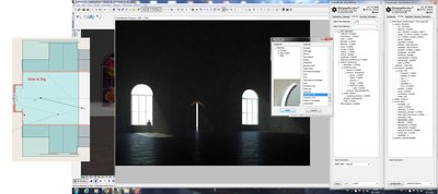

Once you have a volumetric cube material, export it - and then just re-import everytime you need it.
After more experimenting - the size and location of the cube is the key. You don't want it too big, otherwise it blocks the sun too much - it just needs to cover the area you want the rays - no bigger.
This is a PMC version - love the dust specs!

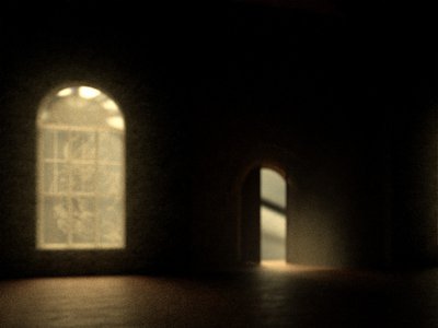

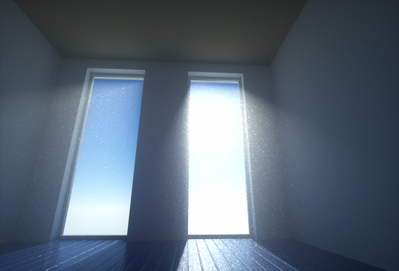

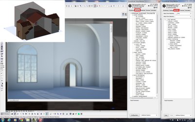

Hi Paul,
Unfortunately I cannot get it work to get the fog OK ans for sure not to get the xrays like you did :(
Maybe you can send/upload the scene to learn from :?:
I am having a nice scene here to experiment... nut I'll try to make a smaller scene and try to copycat your scene to get this work and understand :mrgreen:
btw: these images are done with hdri background, but I could not get the fog/xray effect work with daylight either.
greetings, Jeroen
not getting the fog effect yet, but the scene has potential for it :-)
Looks like I was getting somewhere, but now I don't now how I got to this one :-(

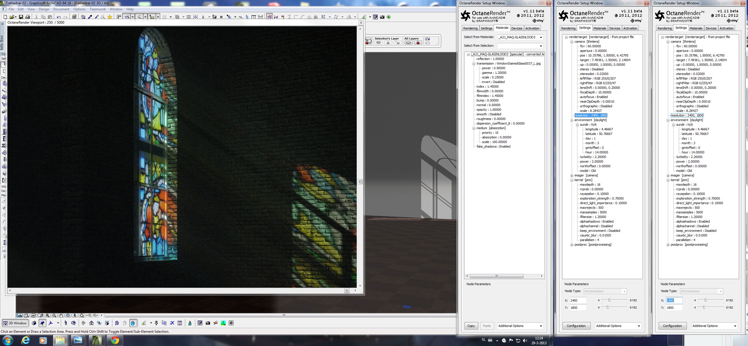

Posts: 1962
Joined: Fri Apr 06, 2012 3:57 pm
Location: The Netherlands

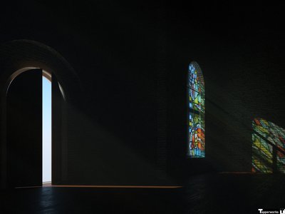

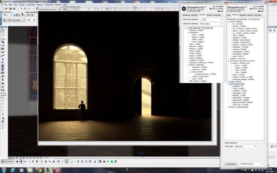

Step by step I am getting somewhere.
I started out this trial after seeing the beautiful render by enricocerica,
http://render.otoy.com/forum/viewtopic. ... 62&start=0
This is the latest render trying to make a scene like enricocerica to learn using fog and stained glass.
I added the settings in the prntsreen for you to make comments if you like to improve.
I did not get a good result in AO yet, but in PMC I am getting rays to start with :D
greetings, Jeroen
4090+3089ti & Quad 1080ti
http://www.tapperworks.com
face_off
Posts: 15799
Location: Adelaide, Australia
Nice work Jeroen.
You can increase caustic_blur to smooth out the light beams.
The fog_specular material should have fake_shadows Enabled I think. Also, scattering_direction = 0.75 seems to increase the effect. You can also increase the "medium" scale to increase the effect. I like the idea of using some turbulence in the "scattering" pin.
Paul

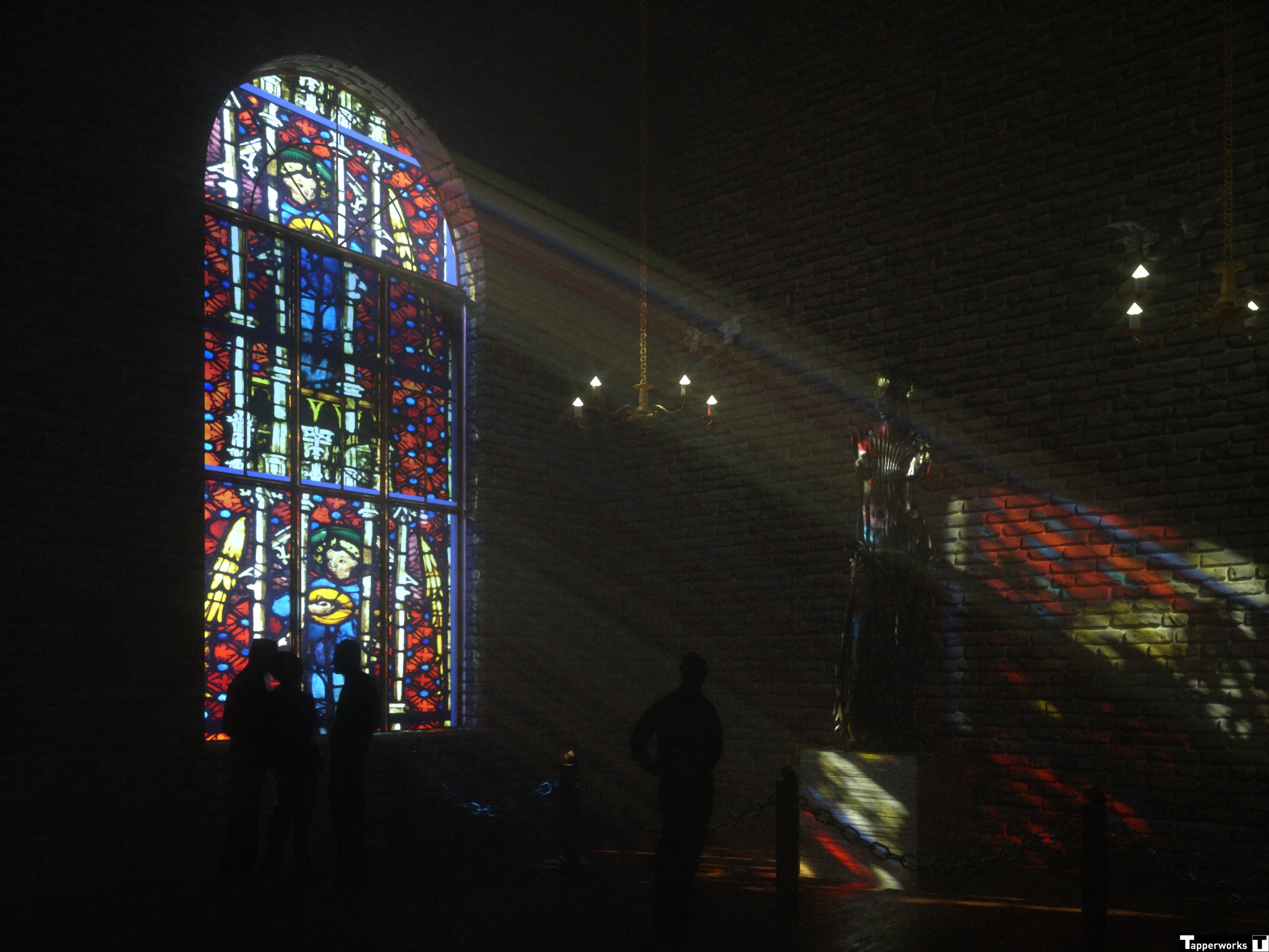

Posts: 1962

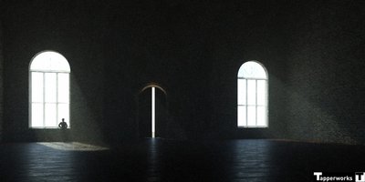

tnx Paul,
This time I used the material from the DB: octanefog (might have been octanefog from Karba... I am not sure now)
and I added some objects to make the scene come more alive.
I got the look and feel I was looking for: so mission accomplished,
but I still have to experiment more with the fog material in combination to different scenes to understand the settings and get to the next level.
I also combined the fogmaterial with lights and just a little bloom and glare effect to see if that work together.
The image is almost a straight render; the only after effect I did was making the people darker while I was not satisfied about the people.
I used 2d silhouettes, because I don't like the 3dpeople form the standard library.
greetz, Jeroen
