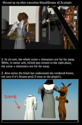

Bazuka,
The new plugin I just tried (Maya2Octane v2.3a), here's the symptom:
Environment:
Maya 2010, project's unit based on CM, the scene has reference files, and I also tried another test to import all the reference files as well.
In the plugin I choose Octane pre-2.3; with Camera exported
Problem encountered:
1. The old problem of messed up rig came back.
2. Another Error:
// Error: donkib:loft7 (Loft Node): failed to compute the result.
// Warning: donkib:attachCurve4 (Attach Curve Node): invalid input curve. //
Loft node, and Curves... Maybe the plugin still evaluates nurbs?
3. if choose Scale as CM in the plugin, in Octane the whole scene is super far away.
4. If choose scale unit as Meter in the plugin, in Octane whole scene remains super far away, EXCEPT nCloth geos!
nCloth geos in this case (Meter based in the plugin) stays where it should be in the frame. Though, the nCloth objects
are within the group nodes of each respective character.
Environment:
2. Another Error:

thx for bugs info
1. ill have to check the group probl, like rigs have and see whats going on
2. i think that objexport can only handle poly mesh, so i think ull have to convert everything to poly, sorry
3. by default script detects the maya unit scale, so u dont have to change anything
i made some test last night and this morning, u can (if u have time) try also, and when i export it i was always getting the box 1x1x1 meter
i had 3ds max so i import the box model into max and check if everything is right,
- set the maya unit scale to cm,
- make box run script,
- open in some other 3d soft,
- then again set maya unit to meter, make box, export, open in some 3d soft and u will see that the box is alway 1x1x1 meter (i hope)
i also notice black line under the render, i think thats the octane i could check exporter with previous ver...
cheers
cheers
