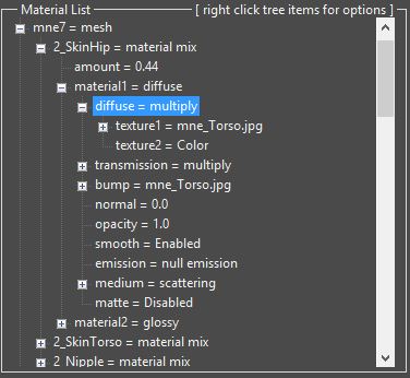

Hi Uwe - that sounds like the msg you get when you try to "retain texturemaps" which there is more the one diffuse map. You cannot import a material with 2 texturemaps plugged into the diffuse and "retain texturemaps", because the node structure being imported has 2 image maps, whereas there is only one image map being retained.

Ah, I see. I did have only one map in the diffuse channel, but it was in combination with a color value.

"Retain existing texturemaps" will still work where there is a texturemap mixed with an RGBspectrum (as you have in your case). It's only the case where there are two texturemaps mixed/multipled that the "Retain existing texturemaps" cannot be done, since it won't know which map to use.
