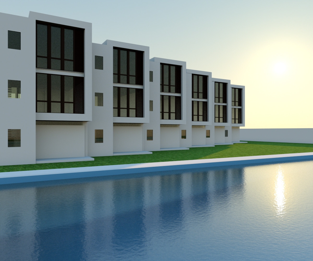

merid888
new test octanrender, time 47 seconds, sixe 1200 x 1000 px, directlight, ambien oclussion, samples 500, 3dsmax and octanerender 1.02 for max
regards
i love it the sun in the water, nice, thank you karba !!! :D
