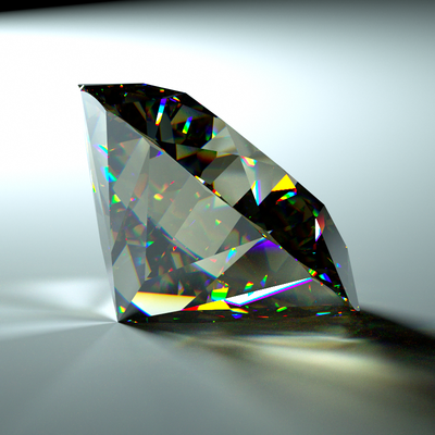

Okkkkkkkkkkkkeeeeeeeyyyyyyy Guys!!! We slowly get to a point where i really get satisfied! :-)
I rendered your scene again and used on of my HDRI´s. I also pushed the caustic blur to 0.01 and set the " dispersion_coefficient_B" float to 0.025. This is the result i got after 6000 samples. Really much much better. Not perfect - but much better. Looks like we get to the point, where octane can show what it is capable of! Thank you so much, all you help. THANK YOU! Soon we will have the perfect Diamond rendering!

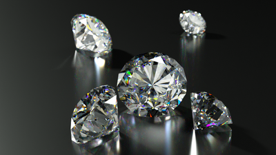

it seems that your scene is 100x bigger than expected :roll:
this explain your emission settings completely out of scale.
here is the result reducing of the scale by 100, i've only adjusted the emitter and switched to PMC with caustic blur to 0,01.
in the second one, i have changed the diamond material with the one finded in livedb/materials/non-orgnic/glass/diamond (note, the material looks withe but it's only necessary to connect the specular material inside the macro node) ;)
ciao beppe
