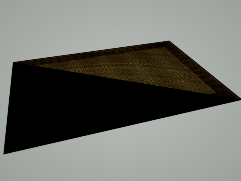

I finally found some time to play around with this amazing plug-in a little more.
I wanted to build a little room and noticed something strange with a carpet, I was using.
I then isolated the carpet and did a sole render of it.
There is nothing else in the scene, beside some Inf. Lights, I use to set up my scenes in poser and the Poser Ground plane.
The carpet itself is called "CarpetLaura" and did come with an apartment set, iirc.
The mat. set-up for the carpet is very basic, just a diffuse material with an image file attached.
What could cause, that it's only rendered half ways (diagonally)?

Hi Erick
Looks like the prop only has 2 polygons. Try turning smoothing OFF for the carpet material in the Materials tab of the plugin.
If that doesn't work, export just the carpet geometry to OBJ and email it to me. I'll take a closer look.

Erick
Posts: 249
Joined: Thu Sep 13, 2012 9:40 am
Turning smoothing OFF fixed the issue for me :D
Thank you!
vipvip
Posts: 726
Joined: Fri Apr 22, 2011 9:28 am
Erick, i don't know if it can help you but 1+ year ago, i has such problems with the octane standalone version:
the main reason was that the exporter i used didn't convert well the mesh normals when exporting in OBJ format ( specially with the lightwave 10 exporter ).
Fixing (unifying) or flipping manually normals resolved this problem because when you unckek the smoothing parameter, you will give faceted output of your object ( of course with a plane it is not a problem...)
Actually, Blender and Lightwave 11 export correctly OBJ Format... it is not the case with all the apps ( sometimes, there's options to tweak normal/smoothing/face orientation parameters and avoid this....)
