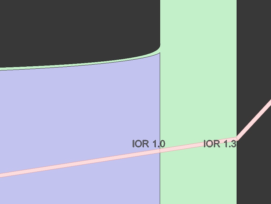

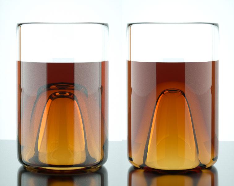

truerender wrote:So everything on the picture
Try to use 2+3 and set IOR to 1 for liquid
Left - IOR 1.33
Right - IOR 1.0

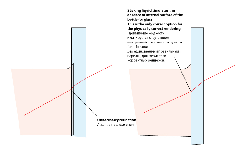

Left - IOR 1.33
Right - IOR 1.0
This is bad idea... This is no correct anyway!
The refraction will be with glass IOR And in real Life it is other.
Why i must do it? Better repair the render engine!
Can you check this or you do not know what to do? Or you do not want?
Karba
Posts: 2300
Left - IOR 1.33
Right - IOR 1.0
That is correct way.
glass has 1.3 ior
liquid has 1.3 ior
So from glass to liquid there is no ior difference.
So ior between glass and liquid is 1.0 or close to 1.0.
Render engine is correct.

Karba wrote:
truerender wrote: Render engine is correct.
I don't think so
IOR is relative to the material and not difference between 2 materials
the law says : n_1 . sin(theta_1) = n_2 . sin(\theta_2)
So the light ray goes straight only if n1 = n2.
The fact is that from air to glass (n1 = 1 , n2 =1.5) the ender engine detects the surface but from glass to liquid (n1 = 1.5 , n2 =1.3) it doen't seem to detect the ior decreases.

Karba
I don't think that glass ior is 1.33.
I far as i'm concerned, i would build the scene like this : air (by default io=1), glass ior=1.5 and liquid ior=1.3
PortFolio
4 x TITAN - Win 7 64 - Octane Rocks
Karba
Posts: 2300
bicket wrote:
Karba wrote:
Well, what ior should be between glass and liquid if both has ior 1.33.
Karba
In that case ior between glass and liquid will be 1.5/1.3 ~= 1.153846
